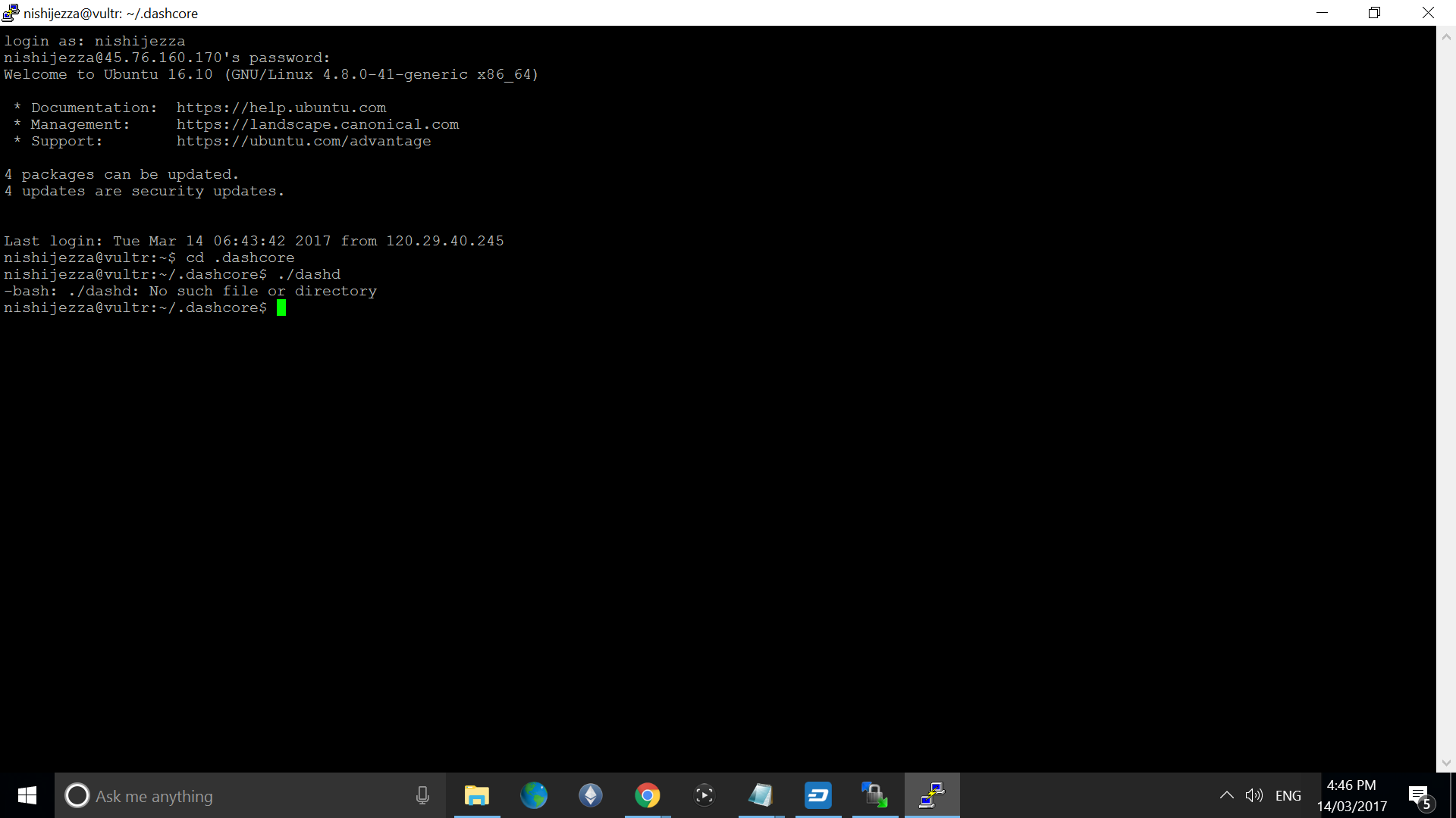

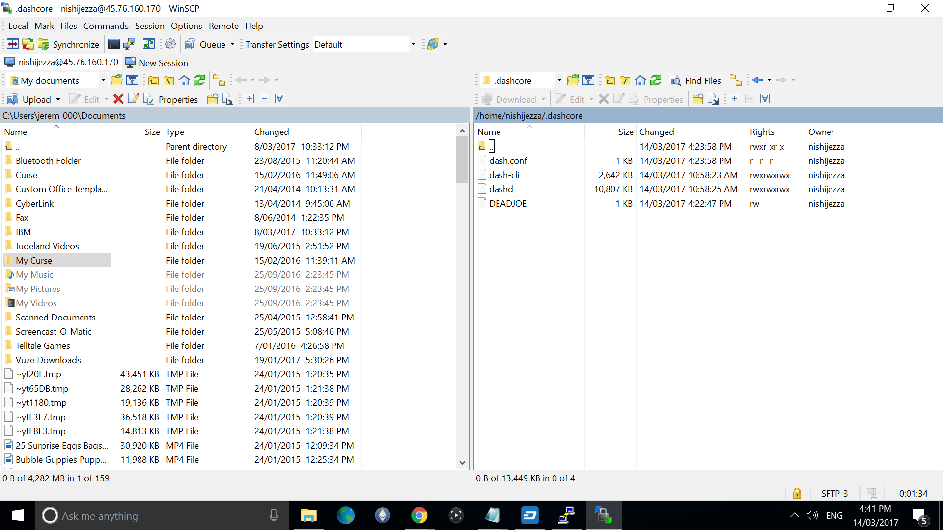

I have followed your instructions to a T up to the above quoted step. At this point, although I can clearly see the file "dashd" in ".dashcore" in WinSCP:
I get the below error when trying to run it in putty:

@ac0 It looks as if you were trying to execute a binary version for another hardware architecture, for example binary for Intel x86 on Raspberry Pi or 64-bit version on a 32-bit machine.
Please submit the results of the following two commands:
uname -a
readelf -a ~/.dashcore/dashd | grep interpreter
