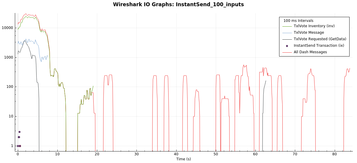

In practice, I sent an InstantSend transaction with 100 inputs (the warning threshold currently defined in Dash Core) on testnet to see what would happen. The transaction was ~14.8 KB and I was expecting around 500-600 KB of traffic (capture with Wireshark). The actual amount of traffic recorded by Wireshark was about 1.4 MB - nearly 3 times what I expected. I repeated it a second time with similar results. Not sure if this is due to very faulty math on my end or errors / retransmissions on the network.
I should mention - neither one of the transactions actually was a successful InstantSend. Both choked with ~700 of 1000 signatures.
Another interesting observation can be seen in the IO graph from Wireshark. InstantSend puts a sudden, heavy load on the network (note the chart is on a log scale - Y-axis is Bytes).
The masternodes have to respond quickly because the quorum votes have to be received within 15 seconds of each other or the IS transaction will timeout. I suspect this is why my transactions failed - it is difficult to see here, but there was actually a second burst of txlvote inventories received outside the 15 second window.

I fell down a rabbit hole looking into this for a few hours. It's a bit off-topic from what you were asking, but I thought it was interesting :).
The amount of bandwidth taken up by an InstantSend transaction compared to a normal transaction is substantial. This is part of why they cost more, right? The number of network messages generated by an IS transaction is:
1 + (Number of Inputs) * (30)
Broken down:
  • 1 - ix message
  • Numberof inputs * 10 - TxlVote Inventory message
  • Number of inputs * 10 - GetData message (to get TxlVote)
  • Number of inputs * 10 - TxlVote message
Using some rough approximations for the size of those messages (129 bytes for txlvote inventory and getdata, 262 bytes for txlvote, 147 bytes per input/34 bytes per output), the amount of traffic would be more than an order of magnitude greater than the size of the InstantSend transaction (more like 20x-40x if my rough calculations are anywhere close to accurate).
I really have no idea how it actually will scale, but I think it is good to contemplate. Given the forward thinking that we see from Dash Core, I am guessing this stuff has been discussed in detail.
