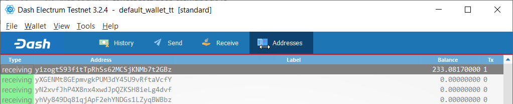

Hello @AntonioR
I am trying the same thing to help you out. I am using Dash Electrum on windows in GUI mode. Here you can see what I get:
I noticed that the faucet takes donations in tDash, so I decided to send 233 tDash back to the faucet! It was not able to estimate fees, so here is how I did it:
The Dash Electrum wallet is fantastic. It is really easy to understand.
