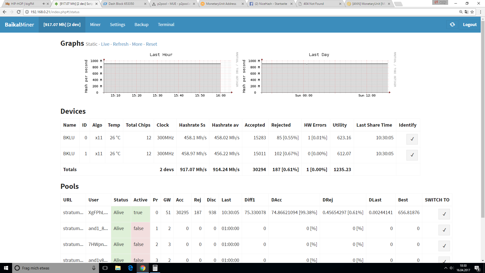

Hello,
I just got my new Giant A900 miner from Baikal and it's all set up from what I can tell. I've tried to join several minin pools, but the miner's web interface says the status = alive, but active = false.
I've searched the recommended mining pools in the Dash mining pools page https://www.dash.org/pools/, but till almost a full day after the rig began operations, the pools have been inactive more time than otherwise. The only pool that seems reliable, I think it hasn't become inactive yet, is the suprnova.cc. The rest of them don't seem to work.
Is there an advantage to mine for several pools? Is it a good idea to have many in the case that one gets disconnected from the miner, so O don't waste Hash power by mining solo?
What are some of the mining pools that do work right now for you? Here are the ones I've tried. Any tips and comments are appreciated.

Here's a picture of the pools. What are some of the numbers I should be paying attention to and what do they mean?

In my experience the machine can only be connected to (active: true) one pool at a time.
What your interface is telling you is that those pools are in fact active, meaning, those pools are up, and can be connected to. The Active tab will tell you which one is connected currently.
Your miner is connected to Suprnova, since I assume is it listed as the first miner on your Miner tab. Those other pools are failovers, in case the others are down. If Suprnova went down, your 2nd pool, the dash02.p2pool would connect.
99% of the time, the first one in the list will be Active, and the one listed there should be your preferred pool.
If you roll over the tabs you'll se what they are
PR - Priority (from the Miner tab)
GW - GetWork
Acc - Accepted Hash Rate
Rej - Rejected hash rate
Disc - Discarded hash rate
Last - Last Share Time
Diff1 - Difficulty of 1 Share
DAcc - Difficulty Accepted
DRej - Difficulty Rejected
DLast - Difficulty of Last share
Best - Best Share
If you'd like to know more about what those mean, take a look into how Bitcoin mining works.

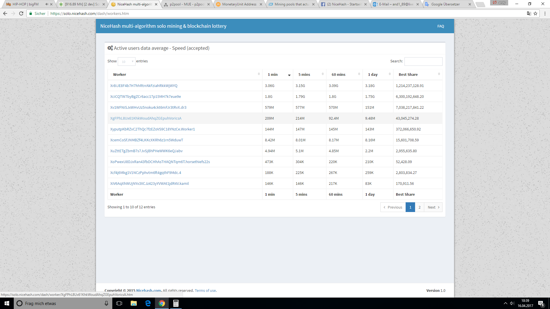

Hello
I have a question Why I mine at nicehash solo pool dash only ca.220mh / s at all other pools 900 mh / s
Can you help me

I don't have much experience mining, so some of my statements may be wrong, bit from what I know, mining has a lot to do with experimentation. Like @LMC said, you probably want to try out different pools and stick with the one that works for you. Give a try to p2poolmining.us/p2poolnodes
