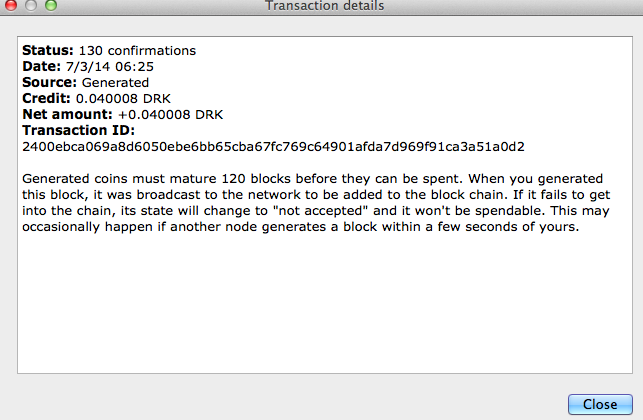

I also attached two photos straight from a receiving wallet that shows the transaction details, and the status of mined for the pool fees we are running, and a payment for a personal miner on our pool.
Why are they getting attributed when we have the higher payout // more shares, plus we are paying the mater node fee

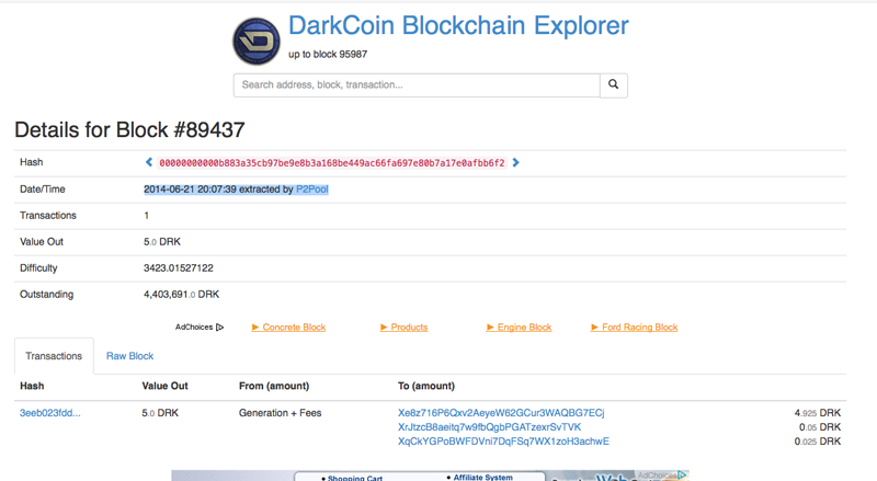

yes that address is correct.
Its setup as a stratum,
if you look at block #89437 you can see that only one has was submmited and only one pool was paid out, ours but it still says 2014-06-21 20:07:39 extracted by P2Pool
I took a picture of the block explorer - we got the full payment for the block .. unless I am missing something I that should make us the finder
How are the extraction statistics even mapped to a pool name // website ??
I can not post links because I have not gotten a link on this forum, but I have looked on other block explores and it does not list anyone or tie it to a named pool
Bottom line, we can look into how to fix the issue, but I we are not a rouge pool. We are active in our updates to the coin daemon and we support the mining community.
