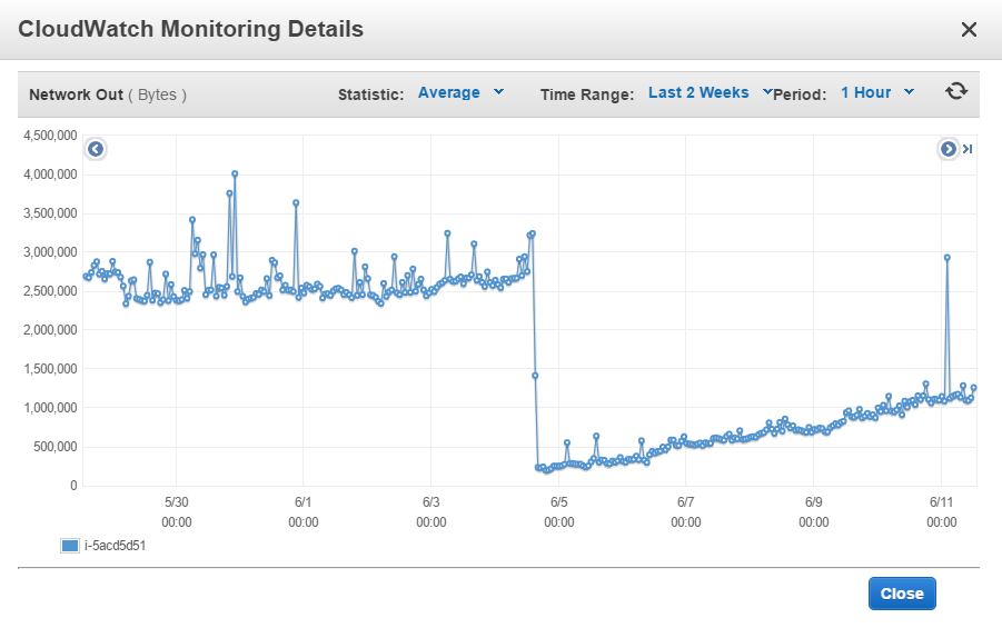

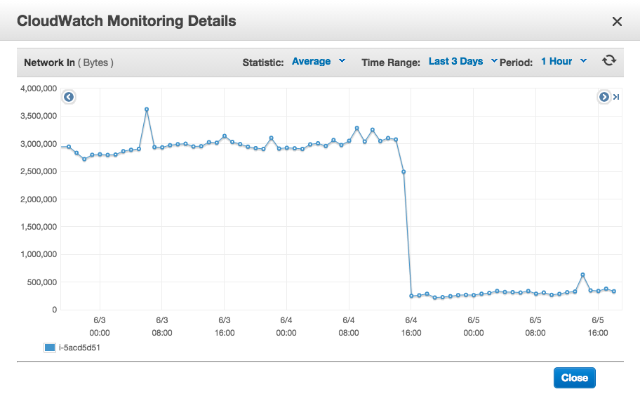

    Looks like dropping the maxconnections had a big effect - currently my MN is sitting at 13 connections and the bandwidth usage has taken a nosedive. crowning, are you seeing the same?

    Looks so, but you need to wait some more days because it needs some time until the connection number hits the maximum.
    I'll wait until my nodes hit my current maxconnections before I draw conclusions.

    Update - Connections up to 60 and network traffic steadily increasing.
    Can anyone explain whats the importance of having a high # of connections? If the bandwidth consumption of having a high number of connections is actually affecting ROI of the MN, whats the side-effect of dropping the max# connections to a very low number?

    The Bandwidth was creeping up up up on my MN so I set the max connections at 16.
    I'll report back here if I notice any weirdness over the coming weeks.
    crowning did you see the same behavior with your bandwidth consumption?

    The traffic is (roughly) a function of the number of network connections, and in theory limiting this number will decrease traffic...BUT, I noticed that my testnodes happily ignore the maxconnection setting, I've set it to 32 and they are up to 44 and 50 again after 2 weeks.
    I'll wait how v0.12.0.x behaves, and if it's the same I'll investigate why the numbers go beyond the set limit.

    I'm seeing the same thing on my side - I set maxconnections = 16 and I'm already back to almost 40.
    My free year with AWS is up this month anyway so all of this is making me think of pulling the MN back private.
