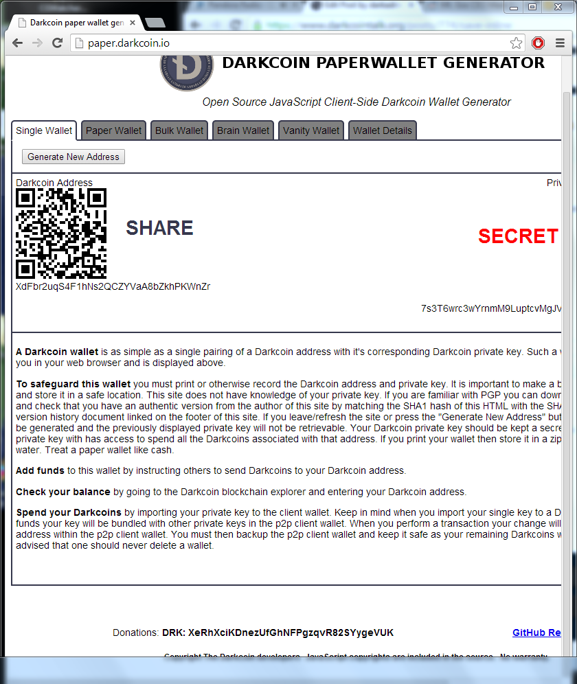

Which paper-wallet generator do you guys recommend?
I notice that paper.darkcoin.io doesn't use the mouse randomization bitaddress.org uses; should this concern me?

InternetApe,
The last tab of http://paper.darkcoin.io is "Wallet Details". Is this functional? Why is it that pasting a private key from the bulk wallet does not accept this address? The result says:
The text you entered is not a valid Private Key!
Would you like to use the entered text as a passphrase and create a Private Key using a SHA256 hash of the passphrase?​
I was hoping to test some vanity addresses before sending to them. Is there another way to do this? Thanks in advance!

InternetApe,
Indeed it looks broken. Anyways, to test the private keys you can import them on a "cold" computer without internet access or inside a VM without "cable connected".
