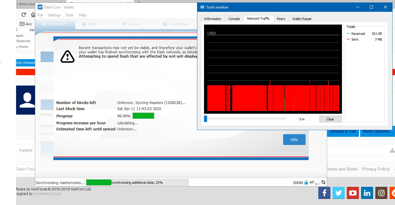

Hello, I have reused an receive address in my DASH Core Wallet, without first making an receive request in my wallet, and now it do not show up in the Wallet Balance. I have used Dash Block Explore and found my transaction, it do exist. And shows correctly that first I received and payment to this address secondly I spend the same amount from this address and thirdly I received and payment to the same address but this third transaction do not show in my wallet balance.
To top it up, I followed an advise to delete the log files and some other files and now I got problems synchronizing the master node ... ay

I use, Dash Core version v0.12.2.3 (64-bit)
As I deleted some log and dat files it have been running all night and still its at 25%, but have send 7MB?
Secondly, of course the first problem I got is still a problem how to get my balance right ...
