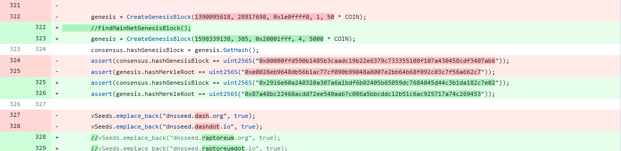

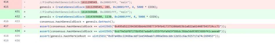

github
Raptor3um/raptoreum/commit/11c6fe93bed1bbb2e7372f550c94da3c8f42c183
They can change time to get genesis block
