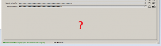

Hi Bertrand256. Cold u tell me how to get back the mn info after I hided it?
@dote go to
Find the file: dmt_cache_v2.json and open it with txt editor.
Close DMT,
Find "MainWindow_ShowMNDetailsPanel" and change it to true.
Start DMT again and you should see it.
It is a bug I found and I think that the next version will have hide/show :)
