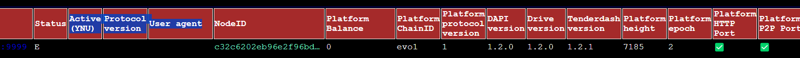

node seems to work!!!!
but on the site https://mnowatch.org/evonodes/
the columns are not filled - Active (YNU), Protocol version, User agent
is this normal? and will they appear later? after the first block?
or do I need to install something else or register somewhere?
Protocol versionUser agent
This is normal for a new node! Your platform data looks good to me, I do believe your node is now setup correctly, congratulations !!!
