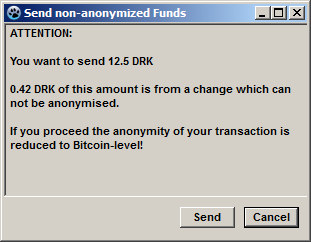

Dead Change - an anonymity issue
oblox
Aug 6, 2014
1,032
537
183
I meant.. but it's connected to the origin address.. Can we make it not connected to the origin address?
Maybe coins get coinshuffled back? That way, the mixing and sending process is the same but the only change revolves around implementing a coinshuffle protocol for all change. Although I am unsure if the other change inputs (output from the initial send) need to be from others at the same time.
The issue is that it is tied by the transaction, not the address. To break this connect would change the basic theory of blockchain. (ie destroy the previous amount and reissue the amount to a new address.) Plus, the amount would be the same and thus suspicious.

Ok, paperThin, now this leads to my next question. I may sound silly and crazy here but this has been in my mind for some time. What if someone can create a crawler to crawl the blockchain and connects all the transactions leading back to the origin?

Hm... I just checked through my Testnet wallet and see that the "Payment to Yourself" fee 0.10 does not show up in my transactions. Unless you look at the PTY fee transaction ID from your wallet, you can't see that this fee is tied to your origin address, because it's not showing up on any of my transactions. This is testnet, but it should be the same like on mainnet. Could someone else check also to make sure, thanks.
I'm thinking if this is the case, can Evan make the change to be similar to PTY fee? and this will be solved? Thanks.

I don't believe this is a worry with the system as is. To do so, you are essentially removing your entry into the masternode list until the new vin is confirmed by a number of blocks equal to approx. the number of outstanding masternodes on the network. By doing so, you are pocketing "change" at the expense of being included in payouts of the block reward until reconfirmed and added back to the list for round robin style selection.
The change going to a masternode that continues to flow onward to other masternodes randomly is an interesting take. But if it isn't combined at some point, isn't it just a matter of a bread trail to be followed before it returns to an address owned by the same person that sent the change?
Yes, you are right.
My thought was that if several people are receiving small change back to new addresses then it would be difficult to tell which change corresponded with with each user. By breaking the amounts in pieces, it adds complexity, but probably not enough.
Simple example: If change due is 0.40 (user 1) and 0.60 (user 2), then 5 payments of 0.20 to 5 separate addresses (2 addresses of user 1 and 3 addresses of user 2).
But I agree, your point is right... not easy to follow, but does leave a trail of bread crumbs. Still working on it... I have a different idea...

Yes, you are right.
In your example about evening out change, I see that, but aren't you essentially creating another denomination. If you are going to send micro amounts (less then 1 DRK), aren't you better off introducing a 0.10 denomination overall into the darksend process?
What if change is accumulated on the masternodes, that continues to flow masternode to masternode after getting combined into new addresses. The masternodes as a consensus lock the last address from the ability to withdrawal and the client keeps track of how much change they are suppose to get back until it gets above a threshold to allow denominations to come back. It doesn't solve an issue if the masternode containing all the coins goes offline even though the masternode consensus should prevent those funds from being able to be sent anywhere other than where the consensus tells them to go. Probably oodles of flaws in there.
The other idea is using the reference nodes but then again, you are introducing a centralized aspect, even if change is small.
