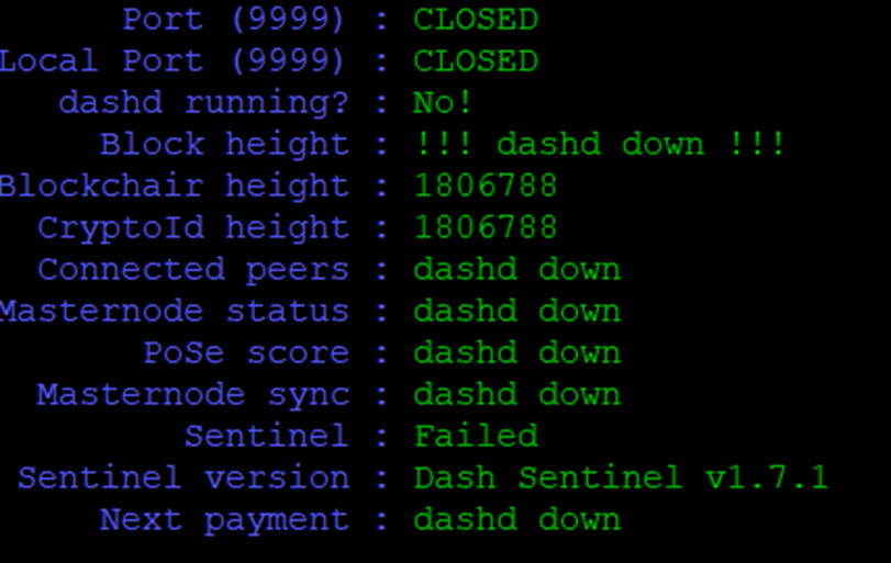

Hey!
I was setting up a Zeus Masternode v18.2.1 and synchronization with blockchain cannot be done for some reason. I see that dashd is down. What can be the problem and how can I solve this?

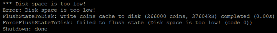

There must be error, can you post final several lines from the debug.log?
Rul
May 8, 2022
41
2
48
22
I have noticed one error below options:
and debug.log says the same issue:

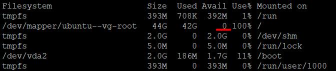

but my server details are:
4 GB RAM and 50 GB SSD

so do I need to get server with more SSD?
Recommended hardware requirements for masternodes mention 60GB
See : https://docs.dash.org/en/stable/docs/user/masternodes/understanding.html
Every masternode owner should at the very least run the recommended hardware requirements for a masternode these days !
@strophy : It would be nice if the official docs were adjusted to reflect that. Minimum hardware requirements for running a masternode are outdated for some time now. Maybe it is even time to shift the recommended requirements (60 GB storage / 4 GB RAM) to minimum requirements and set a higher recommended requirement (80 GB storage / 6 GB RAM ?), just to be on the safe side ?
