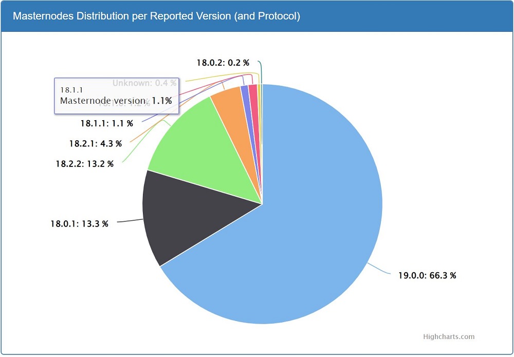

I should mention also that PoSe scores will ramp up especially as MN adoption of v19 gets up to 80%. Once we hit that, v18 nodes should start getting scored/banned regularly.
Masternodes v19 Adoption Progress :
Miners v19 Adoption Progress (far more subject to change)
Earliest possible activation of v19 : May 20, 2023 (depending on adoption progress)

Masternodes don't really put the activation at risk. Based on miner signaling, the network _will_ hard fork once the activation is locked in. Masternodes not upgraded by that time will stop following the chain that the miners are creating and be forked off.
Of course, it would not be ideal for the network to lose such a large number of masternodes all at once and I very much hope to see the adoption rate pick up soon.
We use the BIP9 mechanism that Bitcoin does (slightly modified to reduce the threshold from 80% -> 60% over time if activation doesn't occur).
Dynamic Activation Thresholds
In Dash we have used lower thresholds (80% vs 95% in BTC) to activate upgrades via a BIP9-like mechanism for quite some time. While it's preferable to have as much of the network hashrate signal update readiness as possible, this can result in quite lengthy upgrades if one large non-upgraded entity stalls all progress. Simply lowering thresholds even further can result in network upgrades occurring too quickly and potentially introducing network instability. This version implements BIP9-like dynamic activation thresholds which drop from some initial level to a minimally acceptable one over time at an increasing rate. This provides a safe non-blocking way of activating proposals.
This mechanism applies to the Block Reward Reallocation proposal mentioned above. Its initial threshold is 80% and it will decrease to a minimum of 60% over the course of 10 periods. Each period is 4032 blocks (approximately one week).
