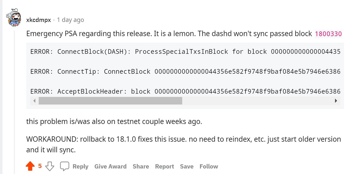

Dash Core 18.2.0, released two days ago on 2023-01-04, contains an issue that does not permit it to sync past block 1800330. Please do not use this version on mainnet! The build will be withdrawn and devs are investigating to find a solution. Further communication will be posted in this thread.
If you have already updated to 18.2.0, please downgrade to 18.1.0. No rescan or reindex is necessary.

The thing that surprised me the most about this withdrawn v18.2 release is that the issue of not getting synced past block 1800330, was apparently already known on Testnet.
Source : www.reddit.com/r/dashpay/comments/103y05l/dash_core_v182_release_announcement/
So what went wrong here ? Did the developers not know about this sync issue on Testnet ? Or did they think they fixed it ?

I would like to better understand what went wrong here too, the chatter I am hearing is that this issue was known, but the chances of it happening on mainnet were believed to be extremely small, so they went with the release anyway, instead of using a fork, which will now be required for 18.2, so the changes in 18.2 will be rolled up into v19.
Reactions: kot
