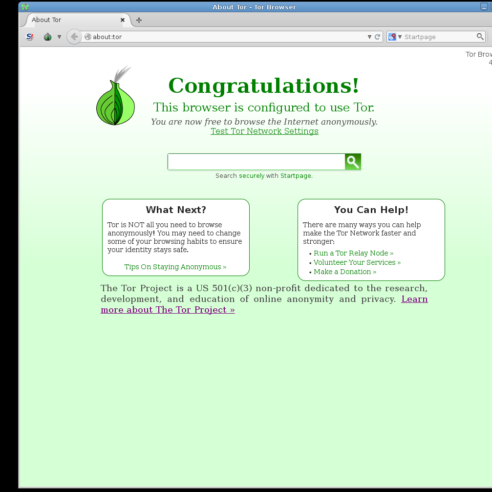

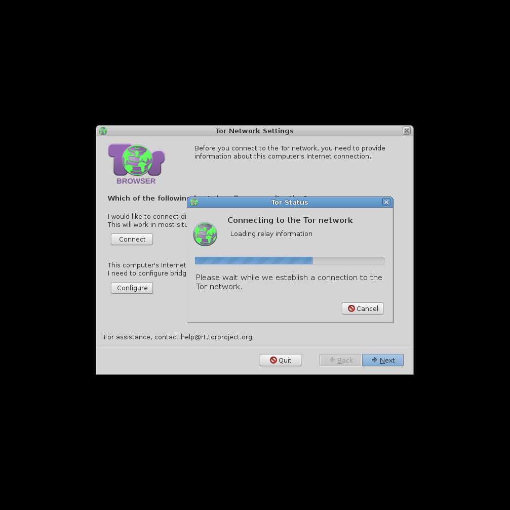

    2. Install the browser bundle, start it and hit connect. You will see a window popping up which shows the status of the Tor connection and it will open the browser as soon as it is connected.

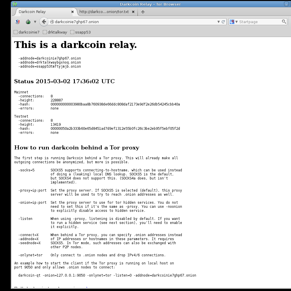

    3. Navigate to http://darkcoinie7ghp67.onion/ with the Tor browser. If you see the website of the Dash relay, your Tor was set up correctly!

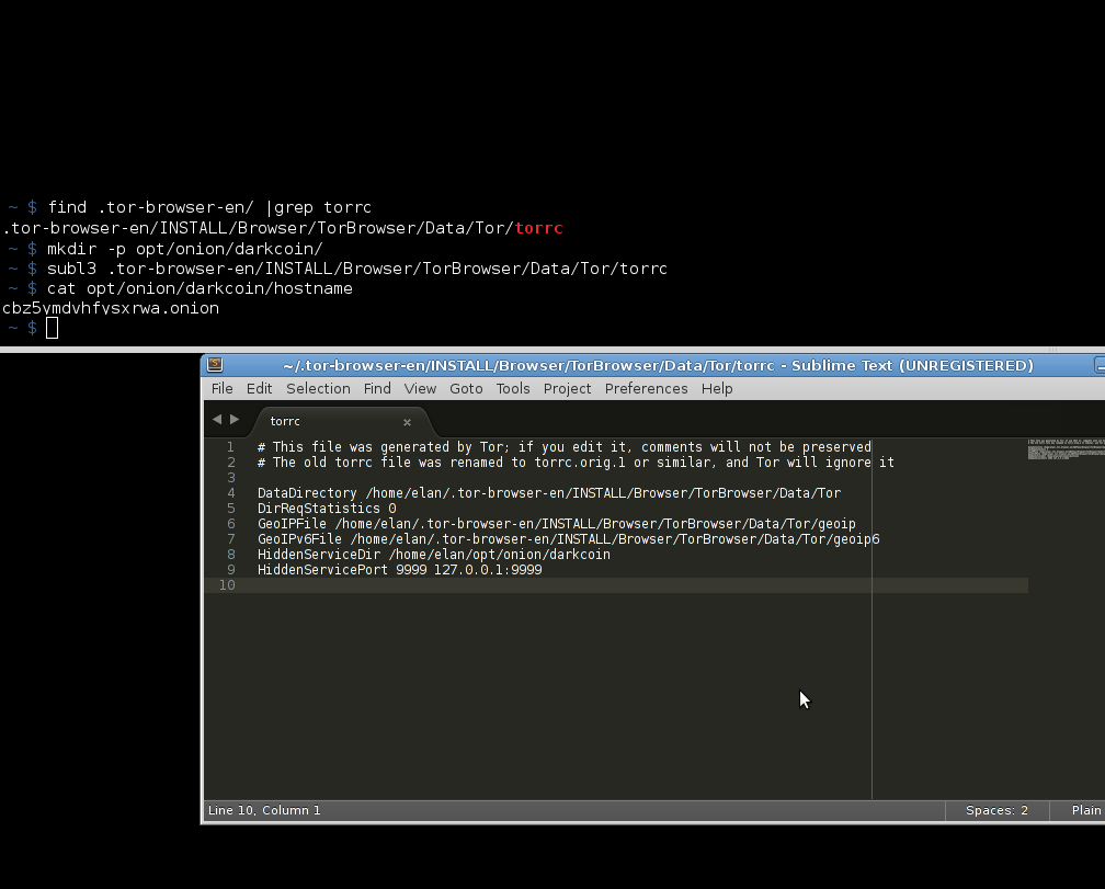

    5. Create a directory for your hidden service, this will store the keys and hostname for your onion address later. For example:
      $ mkdir -p /home/elan/onion/dash
      Make sure you create it with normal user permissions (here: elan), meaning the same user as the one who will run the Tor browser bundle.
    6. Now you have to configure the torrc file of the Tor browser. Search it. Mine is located at:
      /home/elan/.tor-browser-en/INSTALL/Browser/TorBrowser/Data/Tor/torrc
      Open it and add the following lines at the end:
      HiddenServiceDir /home/elan/opt/onion/dash
      HiddenServicePort 9999 127.0.0.1:9999
      This will map your hidden service port :9999 to your local Dash instance at port :9999.
    7. Start the Tor browser again. This will generate an onion address in the background. If the browser starts correctly and Tor is connected, verify the generate address:
      $ cat /home/elan/onion/dash/hostname
      cbz5ymdvhfysxrwa.onion

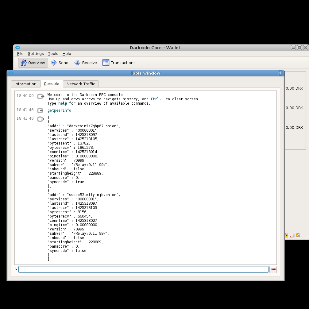

    8. The Tor browser includes a SOCKS proxy listening on port :9150 which allows you to dip into the deep web. Now we are going to set up Dash.
    9. Tell Dash to use the Tor proxy by adding this line to your config file onion=127.0.0.1:9150.
    10. Tell Dash to only use Tor nodes to connect to by adding onlynet=tor to the config file.
    11. Find some onion addnodes. The first one could be my relay at http://darkcoinie7ghp67.onion/. Pass the nodes like that addnode=darkcoinie7ghp67.onion to the config file. Use a search engine to find more nodes. Here is a thread to share Dash onion nodes: Looking for dash onion nodes. Or on the hub: http://thehub7gqe43miyc.onion/index.php?topic=7128.0
    12. Tell Dash it's external address which was created in step 7 with externalip=cbz5ymdvhfysxrwa.onion in the config file.
    13. Last but not least, re-enable the listen=1 flag. You'll need to enable listening for incoming connections, or else your hidden service wont be any service at all.
