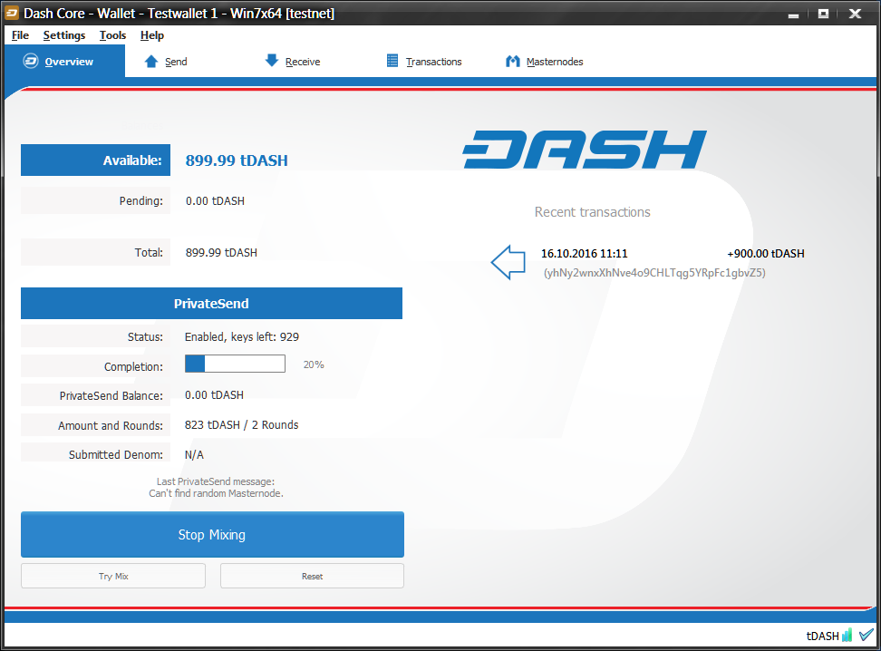

Any status update on the network ? All i'm seeing from my wallets (v0.12.1.0-cce7896) that are trying to mix is "privatesend request incomplete, unknown response"
and the PS compatible masternodes that my wallets are connected to are constantly dropping to very low numbers..
How many enabled masternodes are you currently seeing ?

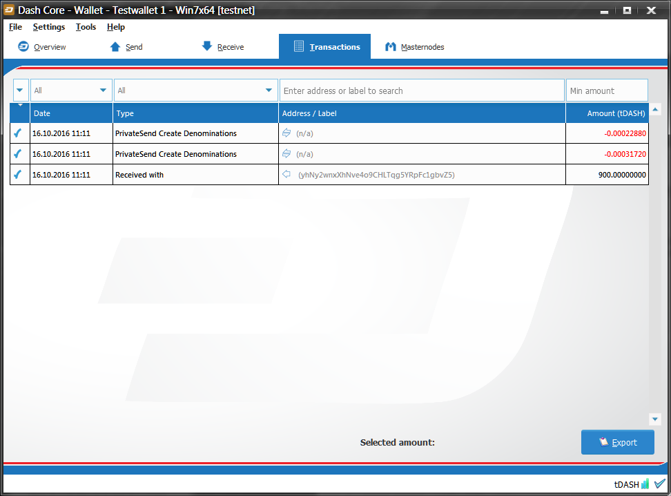

Mixing process is starting now with latest build (v0.12.1.0-66c40e0) but i come across signing time-outs, four times now .. here is some debug info.
No successfull mixing so far...

My mixing stuck at 22% with PrivateSend request incomplete: Collateral not valid.
but continue to use keys (already 3k used) and not create any TXs for 16+ hours
2016-10-24 14:19:11 CDarksendPool::DoAutomaticDenominating -- invalid collateral, recreating...
2016-10-24 14:19:11 keypool added key 15603, size=1001
2016-10-24 14:19:11 init message: Loading wallet... (1558.74 %)
2016-10-24 14:19:11 keypool reserve 14603
2016-10-24 14:19:11 keypool keep 14603
2016-10-24 14:19:11 CMasternodeMan::FindRandomNotInVec -- 5 enabled masternodes, 3 masternodes to choose from
2016-10-24 14:19:11 CDarksendPool::DoAutomaticDenominating -- attempt 0 connection to Masternode 45.55.31.68:19999
2016-10-24 14:19:11 CDarksendPool::DoAutomaticDenominating -- connected, addr=45.55.31.68:19999
2016-10-24 14:19:11 CDarksendPool::DoAutomaticDenominating -- connected, sending DSACCEPT, nSessionDenom: 1 (100.001)
2016-10-24 14:19:12 OverviewPage::privateSendStatus -- Last PrivateSend message: Mixing in progress...
2016-10-24 14:19:12 CDarksendPool::SetState -- nState: 3, nStateNew: 1
2016-10-24 14:19:12 CDarksendPool::SetState -- nState: 1, nStateNew: 7
2016-10-24 14:19:13 OverviewPage::privateSendStatus -- Last PrivateSend message: PrivateSend request incomplete: Collateral not valid. Will retry...
