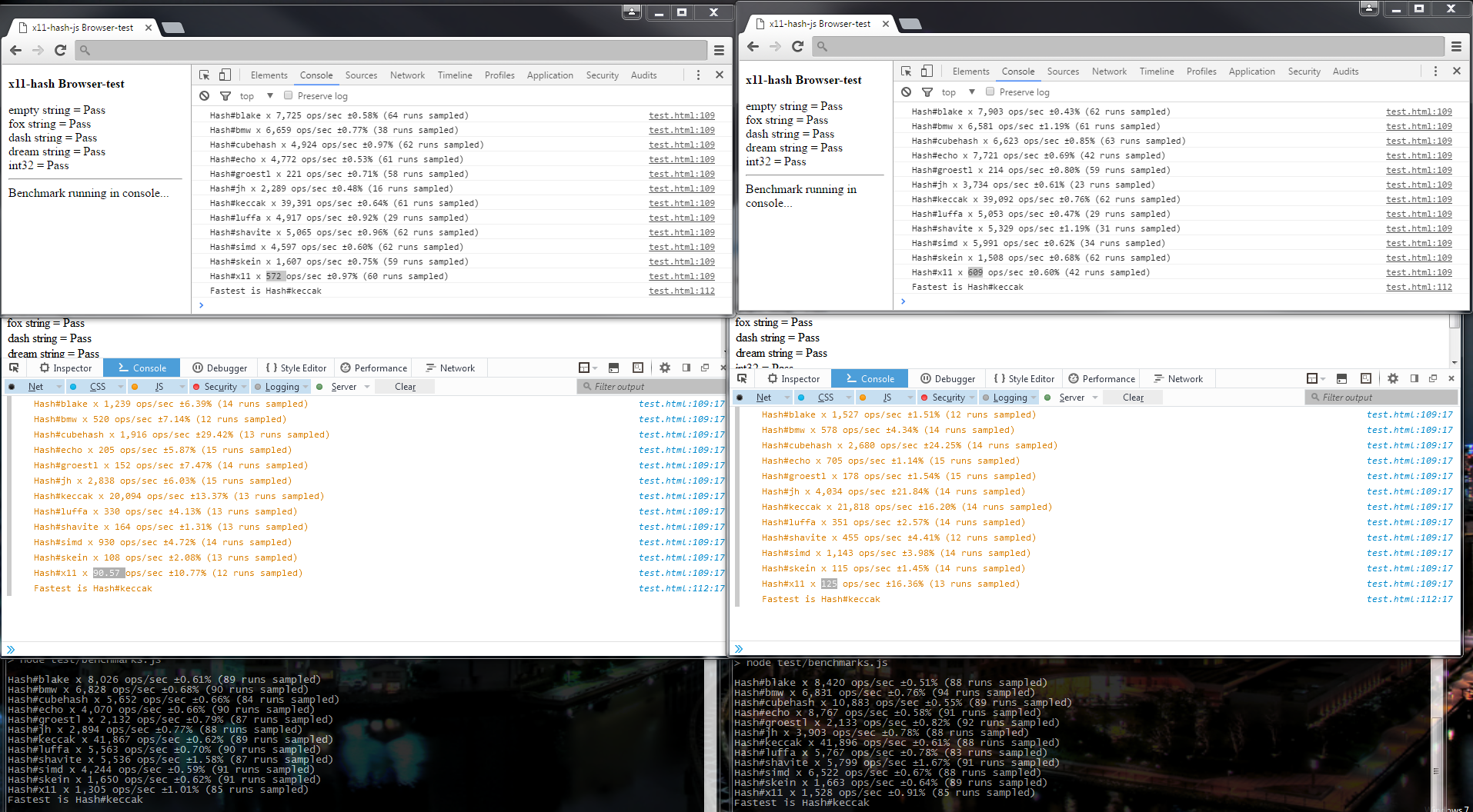

@UdjinM6 & @QuantumExplorer - The major issue is actually the x11 JS performance in browsers compared to NodeJS, it's under half the performance in Chrome and like 10% the performance in Mozilla.
I was able to get 30+% improvement in Node by refactoring forward-for loops to reverse-while loops (which use less instructions) but in Mozilla this totally kills performance (unexpectedly, and probably Mozilla is converting backwards filled arrays to sparse arrays).
So then i tried forward while loops and some allocation reduction which makes the improvement more balanced with Mozilla and Node up and Chrome just a bit improved, results below.
Top: Chrome, Midlle: Firefox, Bottom: NodeJS
Left/Right: before/after optimize
I pushed the browser benchmark: https://github.com/andyfreer/x11-hash-js/commit/00d82f94387ae057b4edf23d911729030dae7ddb - but before/after tests need to be run consecutively because results differ a lot in the browser (probably depends what's running/ whether the browser thread's core is turboed)
I will push what I did tonight tomorrow probably but this needs some attention we should probably setup some bounties or something to optimize this further from the remaining budget.
EDIT: I pushed the optimization for the shared libs which were the low-hanging fruit https://github.com/QuantumExplorer/x11-hash-js/commit/7428675fc103857e87b36b782523388c2841d25e

@andy Cool that you found those improvements, well done! Even though I knew while is slightly faster than for loops in javascript, I didn't realize it could have such an impact.
In chrome at least 60-70% (didn't do the math) seems to be going to groestl, care to replace all the for loops there and see what happens?
I have a flight tmr and am busy tonight otherwise I would do it myself. (or you can wait for me to do it when I have time).

@QuantumExplorer thanks, i will definitely put more time into it, this week is pretty busy though.
There's optimization we can also do with allocations too. The problem is with JavaScript being JavaScript, the different browser runtimes use different heuristics so we just need to make sure we get balanced performance between the major browsers (and e.g. how they handle dynamic memory allocation).
I will look into it some more and add Safari and IE to the testing too when I get more time for it, there's no major rush, the other Evo projects are more pressing right now.
