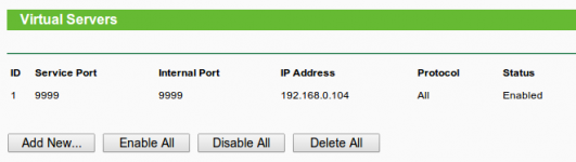

Using that tutorial and successfully building the wallet, there should be no issues with syncing. You could try to allow incoming connections by opening port 9999.
Do you mean like this:
nothing changes.

Exactly like that if that local ip is on the computer running the wallet.

The wallet is synchronized now. What I have changed is to add the following nodes in the "bitcoin.conf" file (not sure this is doing something):
addnode=23.23.186.131
addnode=50.16.206.102
addnode=50.19.116.123
addnode=98.165.130.67
addnode=54.242.50.205
addnode=50.17.98.53
addnode=54.225.43.37
and open the 9999 port as you advice.
