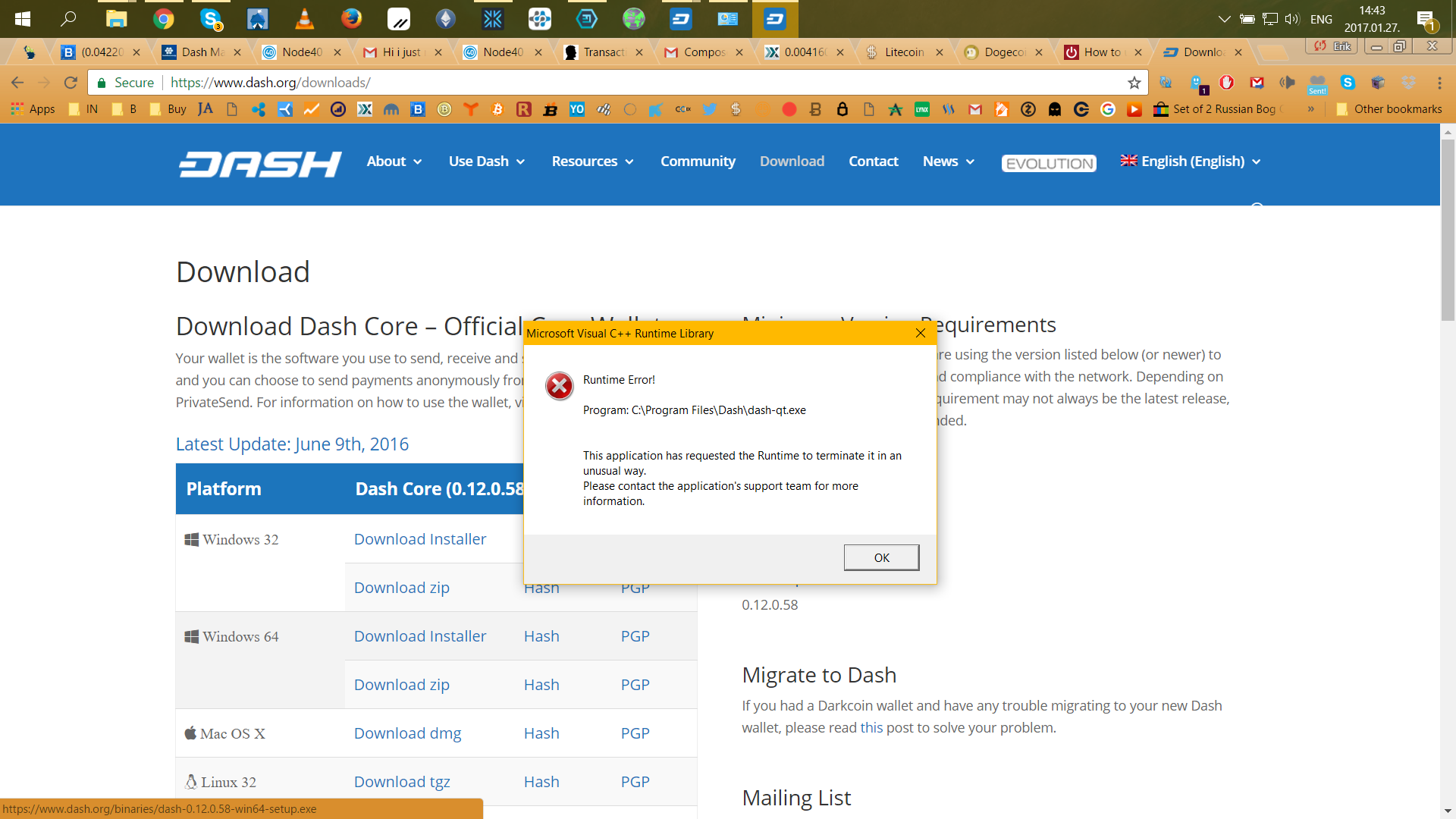

Help ,,, I am trying to open my Dash QT wallet that i just installd but there is a Big Error And I cant fix it Help me
Can you give this a try please:
There's some info on that error relating to corrupted user accounts, the suggested test is to create a new user account and try the installation in the new account. If that works the next suggested step is follow Microsofts guidance on fixing corrupted user profiles.
