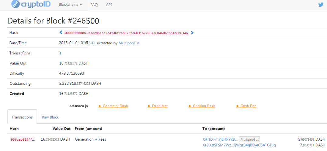

there was something going on as well at :
block 246500
something screwed up at the difficulty there

This block definitely looks very strange... The diff is unsually low, hence, the amount of generated coins is really high... Looks like we had a fork?
Block 246500 was in April. I doubt it has anything to do with your tx tungfa
And yes there was some ridiculously low diff in April - diff even was below 100 for a moment https://chainz.cryptoid.info/dash/block.dws?246514.htm
But there is nothing wrong with such diff in terms of the reward formula - it's just overcorrected itself but never get past hard limits (25 DRK/DASH per block) and restored back to "normal" diff ~2k later as expected https://chainz.cryptoid.info/dash/block.dws?246538.htm

Why did we have such low diff's, do you know? (I'm just trying to understand and I don't remember we had any fork in April.) Thanks. :)
Looking at the blocks 246514 to 246516... lucky XxDotRpSDzgyAkx3jHkLZD8YYZRwbcjmmA he got them all and didn't pay MNs.
