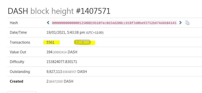

DASH currently has 2MB blocks, they are not variable, but can be smaller if not full. The blocks come at rate of 2.625 minute intervals. A recent block I could find that was full had 5561 TXes in it, which gives a TPS of 35.
Now, the question of how many TXes the network can InstantSend is still an open one because we just released a new version v0.17 that has some performance improvements and we are yet to test it since we are waiting for the fork to hit, in a month or two. When it forks, we will test it on mainnet and confirm the numbers, but testnet shows the IS locking is able to keep up with block production.
In the case that the network is busy and you don't get a IS lock, then the TX remains unconfirmed in the mempool until it is mined, in exactly the same way as Bitcoin does. Meaning DASH's fallback is to be no worse than Bitcoin already is and just keep TXes in the mempool until a block is available. But unlike Bitcoin, DASH's blocks come 4x faster, so no matter how you look at it, DASH is faster.
