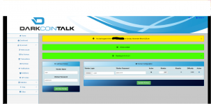

here is the mining pool pic with my worker(temp)

Hi Intertan,
Found your issue since I responded to your support request via the contact form. The command lines you've been specifying show your account name as intertan, but the screenshot you posted shows your account name as intetan.
I hope that helps.
