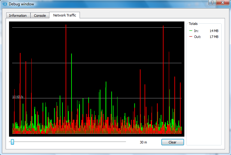

Just took another screenshot of the network traffic:
It seems the network is not forking anymore but why does it still look so red?
Can you explain what red and green colours mean? I have no clue what I am looking at but I would really like to know :)

Green is data received to your QT and red is data transmitted from your QT.
You'd expect to see a lot of green when downloading the blockchain for example.
Hm... So it doesn't mean it's showing the current status of the whole network?
I thought Green is when the network is healthy and Red means there's trouble.
Nope, it's just downloads and uploads.
