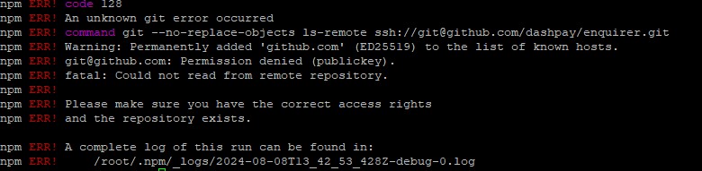

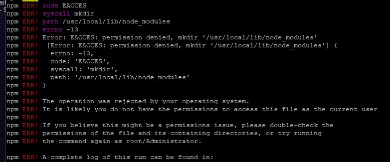

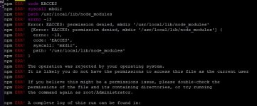

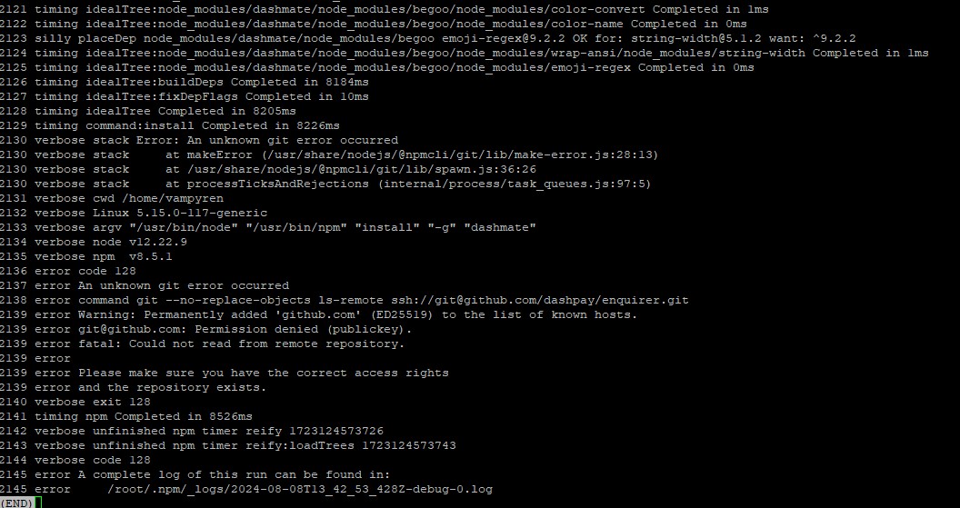

Runnig npm install -g dashmate gave the first errors.
Then i used sudo and got less errors but still erros shown in second image.
Any ideas?

After installing nvm (see above, which vampyren got through ChatGPT), you can then use nvm to install node.js v20 (vampyren was on very old node.js version 12.22.9 the current node.js version can be checked with command node -v)
The actual Dash installation guide (https://docs.dash.org/en/stable/docs/user/network/dashmate/index.html#dashmate-install) has installing both nvm & node.js v20 as follows :
source ~/.bashrc
nvm install 20
So that looks a bit more simplified. Additional steps if node.js keep using an older node.js version after reboot for some reason :
nvm alias default 20
nvm use 20
Install / Update Dashmate :
dashmate reset --keep-data
dashmate update
dashmate start
