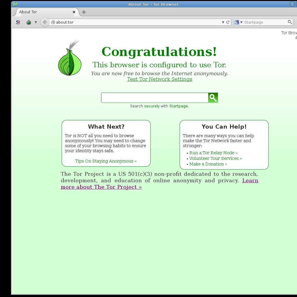

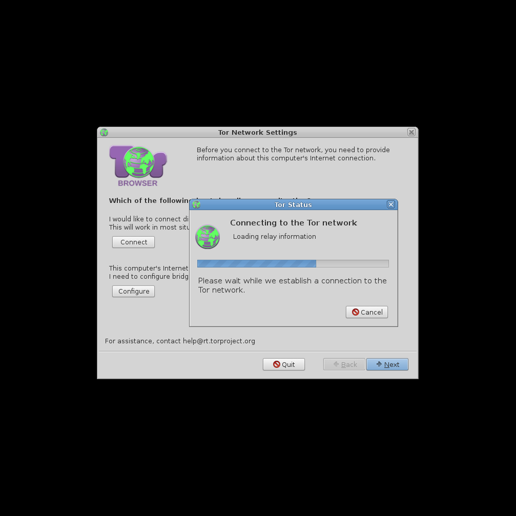

    2. Install the browser bundle, start it and hit connect. You will see a window popping up which shows the status of the Tor connection and it will open the browser as soon as it is connected.

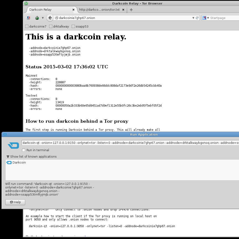

    3. Navigate to http://darkcoinie7ghp67.onion/ with the Tor browser. If you see the website of the Dash relay, your Tor was set up correctly! The Tor browser includes a SOCKS proxy listening on port :9150 which allows you to dip into the deep web. Now we are going to set up Dash.
    4. Tell Dash to use the Tor proxy by either passing the -onion=127.0.0.1:9150 command line argument to the client or adding this line to your config file onion=127.0.0.1:9150.
    5. Tell Dash to only use Tor nodes to connect to by passing the -onlynet=tor command line option to the client (or adding it to the config file accordingly).

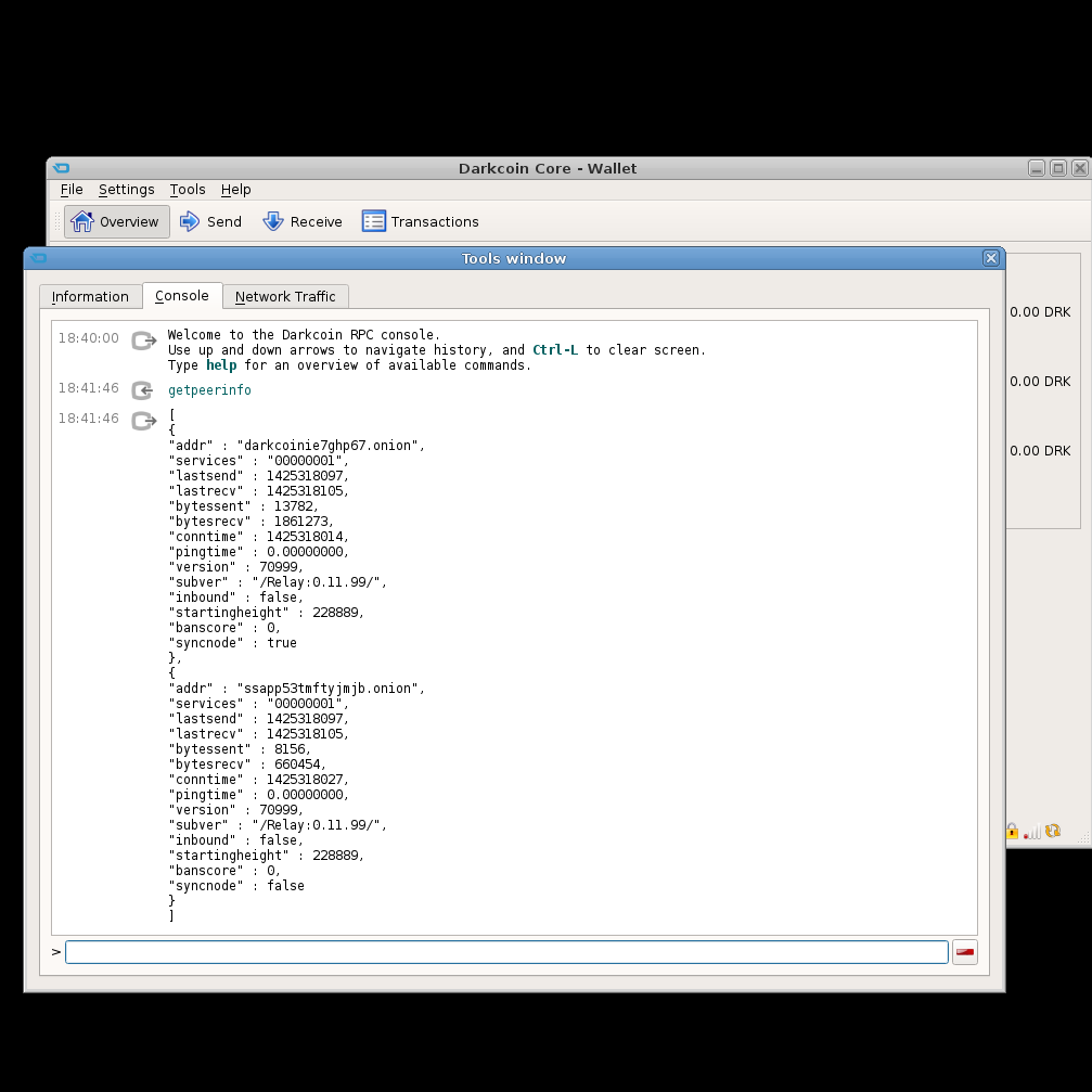

    6. Find some onion addnodes. The first one could be my relay at http://darkcoinie7ghp67.onion/. Pass the nodes as command line argument -addnode=darkcoinie7ghp67.onion or add it to the config file. Use a search engine to find more nodes. Here is a thread to share Dash onion nodes: Looking for dash onion nodes. Or on the hub: http://thehub7gqe43miyc.onion/index.php?topic=7128.0

    If you want to pass this to the command line, this should do it:
    ./dash-qt -onion=127.0.0.1:9150 -onlynet=tor -discover=0 -listen=0 -addnode=darkcoinie7ghp67.onion -addnode=drkcoinooditvool.onion -addnode=ssapp53tmftyjmjb.onion -addnode=j2dfl3cwxyxpbc7s.onion

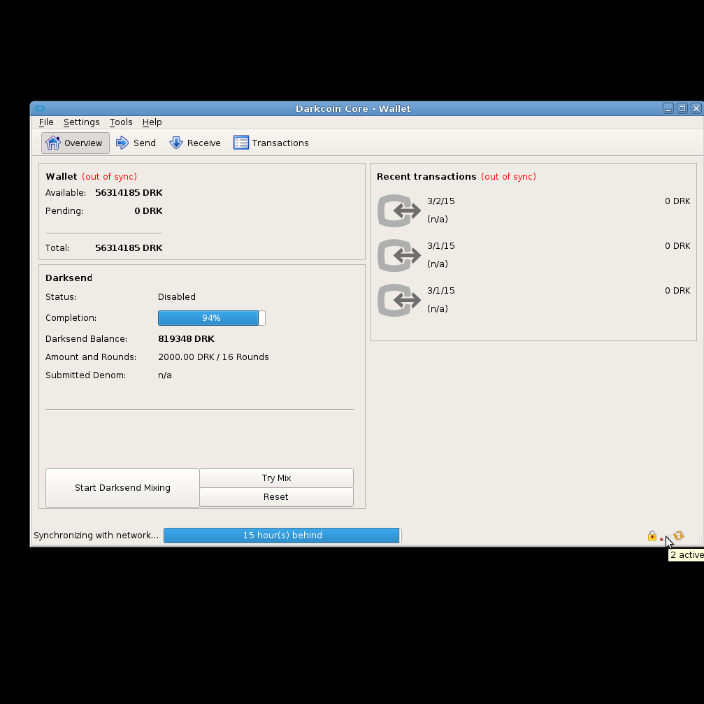

    Here are some screenshots of what to expect:
    Screenshot-0.png Screenshot-1.png Screenshot-2.png Screenshot-3.png Screenshot-4.png Screenshot-5.png
