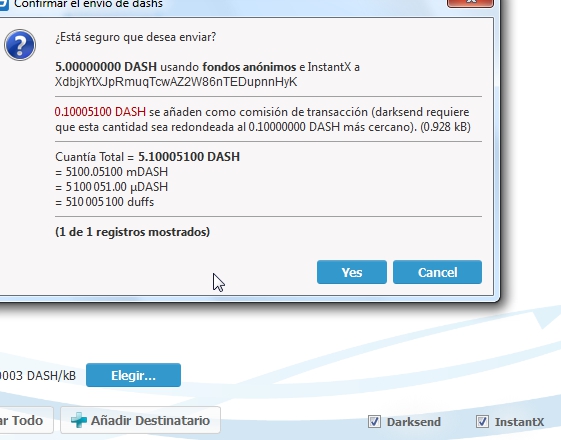

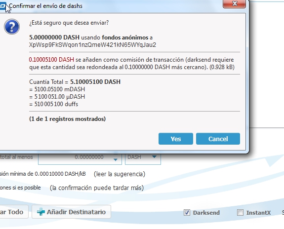

Been getting a 0.1 tx 'commission' fee in some occasions when I make darksend transactions.
Have not found a pattern for it yet. Here's some screen pics.

0.1 DASH - is the smallest denomination of DarkSend at the moment
So the real expenses in DarkSend mode is "ammount" + 0.1 Dash to cover fees...
The small "lifehack" is - you send not exactly 5, but let say 5.099 DASH (with tips! :) ) - so final amount with fees will be also same 5.1 DASH
(so "DarkSend expenses" are reducing from 0.1 DASH to 0.001 DASH)

Ah interesting. Could this not be coded into the wallets? Sort of like wallets today automatically add the tx fee to the transaction? Seems typing 4.99 compared to 5 is significant when you look at ease of use, specially when the difference in cost is 10 times bigger.
If I understood correctly.

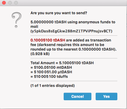

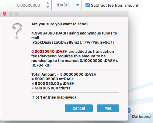

I'm not sure I understand correctly....
Like if you'd want to send ~5 but you are willing to send 4.99 instead of 5 to lower fees?
So instead of this
you want this
right?
12.1 ;)
So instead of this
you want this
right?
12.1 ;)
"no change" - DS tx
"send change to new pub-key never been used on blockchain" - normal tx does it and it doesn't help, also https://dashtalk.org/threads/dead-change-an-anonymity-issue.3019/
Yes, that's what I want, and automated ideally, instead of my having to do the math for an exact number to send.

The wording is confusing. Says that it will add the 0.1 as a transaction fee, but what it seems to do is add it to the transaction its self, right?
To be huber clear.
The wallet ads funds to the original transaction until it is denominations of 0.1 and so you end up sending a bit more then you initially typed?
Or it adds that 0.1 as a tx fee?
