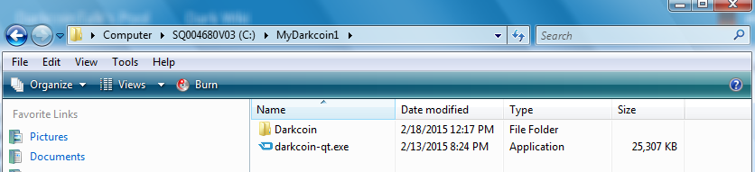

Bergstrom, Ok, so in windows the Darkcoin folder by default is stored in C:\Users\username\Appdata\Roaming... The directory is too long.. I'm making a quick guide here so this is what I've done:
Go to C:\ create a new folder, name it "MyDarkcoin1" and another folder, name it "MyDarkcoin2".
Assume you already have the darkcoin-qt.exe that you downloaded and stored somewhere on your computer.
Copy darkcoin-qt.exe and paste it in each folder.
Also create a sub-folder and name it "Darkcoin" for each of those folders, here's a screenshot:

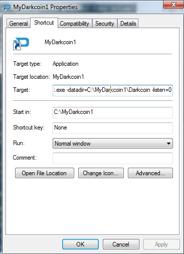

A) STEPS TO CREATE A SHORTCUT FOR THE FIRST FOLDER:
To make a shortcut: Right click on darkcoin-qt.exe and choose "Create Shortcut", then drag it to your desktop.
Rename this shortcut to "MyDarkcoin1".
Right click on this shortcut, choose "Properties" and open the shortcut.
In "Target", make sure you have this line: "C:\MyDarkcoin1\darkcoin-qt.exe -datadir=C:\MyDarkcoin1\Darkcoin -listen=0"
In "Start in", make sure you have: "C:\MyDarkcoin1"
Here's a screenshot of the shortcut properties:
