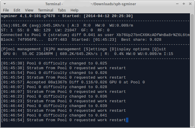

    So the only reason they recommend a higher hash rate is to avoid a lower frequency of being payed?
    It seems that my hashrate is so low that I am unable to submit a share before moving on to the next work share. With a regular pool I do not run into this issue. Is there anyway to reduce the work restarts?

    work restart is common in p2pool.
    you can use custom difficuly, -u address+0.004 (example).
    regular pool : target never changed between blocks
    p2pool : share chain target changed between blocks
    https://en.bitcoin.it/wiki/P2Pool

    Is there a good custom difficulty setting for smaller miners, less then 1mh/s to avoid so many work restarts?

    Work restarts are "the normalest" thing you can get with p2pool and does not affect your mining. Its just a technical detail spamming your sgminer. Ignore it :)
    Try +0.001 with 1 MH/s. Decrease the number if you don't like the results. You will see you get a lower share difficulty assigned and more accepted shares. Don't set it too low, this might spam the server and you get more rejects. Just play with that number until you like it.

    Doing [p2pool address]+0.001 works very nicely. Seems that there is a bug in SPH-sgminer 4.1 though. When switching to a regular pool from the same config file, it keeps the same p2pool difficulty and doesn't retarget.
