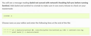

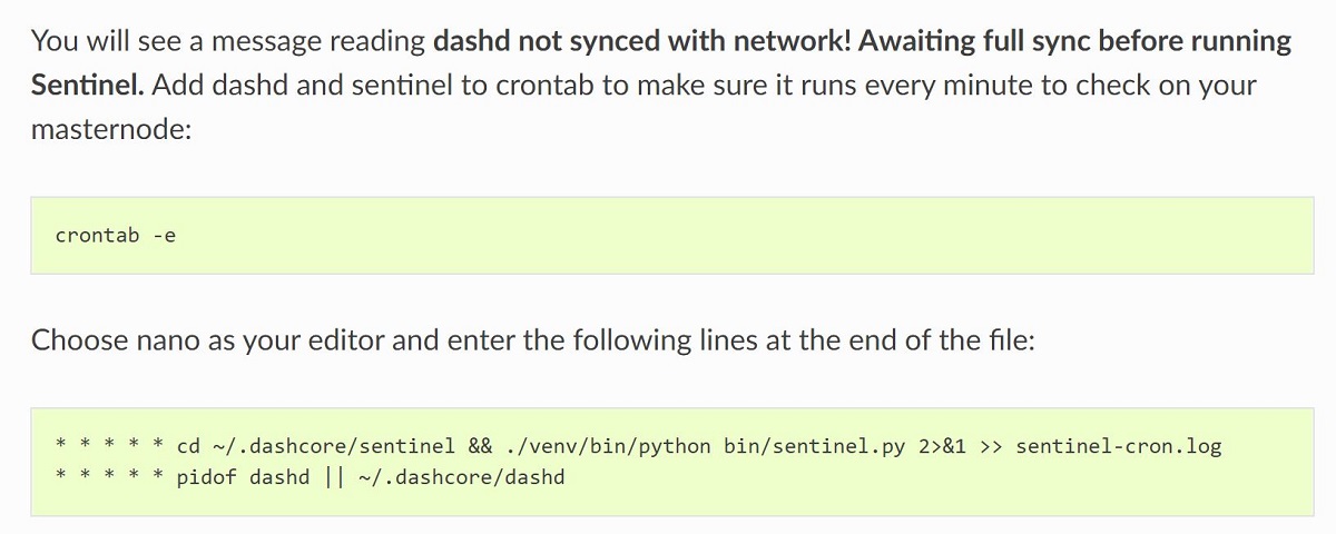

You need to check if you have enough diskspace, enough RAM, installed enough SWAP space, have sufficient CPU power and have a restart script or command active on dashd (for example : * * * * * pidof dashd || ~/.dashcore/dashd in your crontab)
