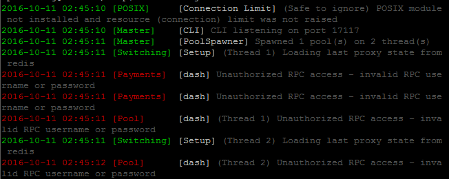

    Hi there,
    I have dash coin daemon running on port 9998 but neither MPOS nor NOMP can connect to it. It seems to reject any access to the RPC port with the supplied username and password. Here's the error that SSH throws when I ran:
    cd nomp
    node init.js
    2016-10-12 02:55:03 [Pool] dash Unauthorized RPC access - invalid RPC username or password
    I'm positive that my dash.json & dash.conf are all good and have the right RPC username or password.
    PS: I'm using NOMP as the stratum server & MPOS as the front end.
    Please, any help will be appreciated.

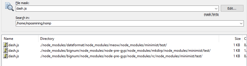

    when I search for dash.js, there are 3 files pops up. Am I going to apply the changes to all of the files? Here's the screenshot

    oops, I meant dash.json, the one in pool_configs folder :)

    I got the same error @UdjinM6 :( This is what I did:
    1. I changed the rpcuser and rpcpassword on dash.conf, dash.json & global.inc.php
    2. I restarted the daemon by logging in to the root and run this command on ssh:
    service ssh restart

    Errr.... That's not how you do that. You restarted ssh daemon which has nothing to do with dashd. You should run "dash-cli stop", wait few seconds and then run "dashd" (if you have them in /usr/local/bin or any other globally available place, otherwise "cd" into folder with dashd and dash-cli first and then "./dash-cli stop", wait, "./dashd").

    Oh sorry. Yes,thank you for that @UdjinM6 . But I received the same error running that command. It's the same error I got from running the stratum:
    I don't understand. I got the same rpcuser &rpcpassword on both dash.conf & dash.json :(

    Ah, right, my bad! Should stop daemon first and THEN change username/password. Kill it via "killall dashd" and start again via "./dashd".

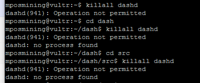

    It says dashd (941): Operation not permitted. I also tried on dash/src but still no luck. :(

    You need root privileges, try sudo killall dashd.

    It worked! I love you man @Balych ! This is what I did for others who are having the same problem:
    1. Login to your root in ssh.
    2. run sudo killall dashd
    3. Then changed the rpc username and password on dash.conf, dash.json & global.inc.php.
    4. Then log back in to ssh. But this time, login as user.
    5. "cd" into folder with dashd and dash-cli and run "./dashd"
    6. Finally, "cd", then "cd nomp", then "node init.js".
    Cheers @UdjinM6 & @Balych !! You guys are the champion!

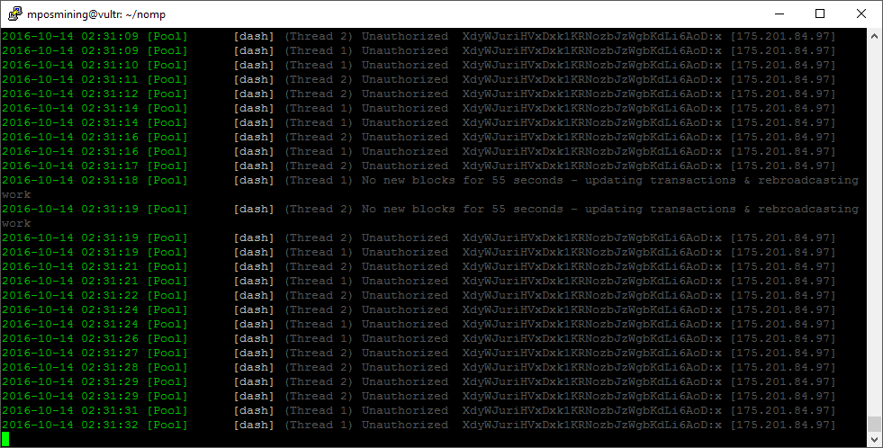

    I noticed that I still got this
    2016-10-14 02:39:06 [Pool] [dash] (Thread 2) Unauthorized XdyWJuriHVxDxk1KRNozbJzWgbKdLi6AoD:x [175.201.84.97]
    And it says "No new blocks for 55 seconds - updating transactions & rebroadcasting". Did I miss something?

    You probably misconfigured this part

  18. UdjinM6
    UdjinM6 Official Dash Dev
    Dash Core Team Moderator
    Joined:
    May 20, 2014
    Messages:
    3,637
    Likes Received:
    3,536
    Trophy Points:
    That port is for mysql iirc and looks correct. Is "XdyW...." actually registered on your mpos as a user with password "x"? If not, there is no wonder he is rejected.

  20. UdjinM6

    Yeah. That's what I'm thinking too. Darn. Maybe this miner with "XdyWJuriHVxDxk1KRNozbJzWgbKdLi6AoD" is a leftover from the past user that I've created for uNOMP mining pool. I'm going to delete the other user directory that's trying to connect to the recent mining pool that is mpos-enabled pool. But check this out please:
    This is mainly the problem I'm having with DASH. The "No new blocks for 55 seconds ". I have not encountered this with lite coin or bitcoin :( Somehow, I think that maybe I configured and connected to the wrong port or diff for DASH @UdjinM6 . Is that right? Please correct me if I'm wrong.

  22. UdjinM6
    Joined:
    May 20, 2014
    Messages:
    3,637
    Likes Received:
    3,536
    Trophy Points:
    That's not an issue at all imo and works as designed:
           /* Some miner apps will consider the pool dead/offline if it doesn't receive anything new jobs
           for around a minute, so every time we broadcast jobs, set a timeout to rebroadcast
           in this many seconds unless we find a new job. Set to zero or remove to disable this. */
        "jobRebroadcastTimeout": 55,
