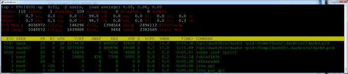

Restart the dashd as the dashadmin user....
Verify that the dashd has restarted successfully before moving on, otherwise troubleshoot your changes.

Now that the data has been copied over, you can again restart the orginal node as the dashadmin user....
sudo systemctl start dashd

Next, we register the file with systemd and start the daemon.
sudo systemctl daemon-reload &&\
sudo systemctl enable dashd02 &&\
sudo systemctl start dashd02 &&\
echo "Dash02 is now installed as a system service and initializing..."
