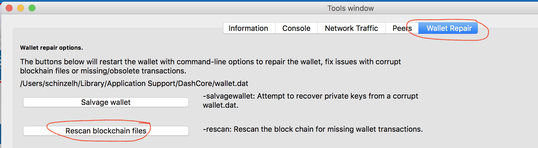

Try to rescan the blockchain for missing transactions using the wallet tools:
I did it. Still nothing.
