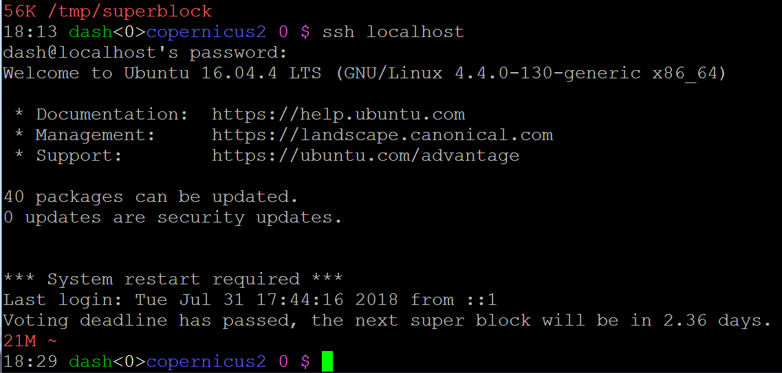

If the above worked and you got an output similar to mine, great, proceed with the below to make the function run whenever you login or whenever you invoke it directly with the superblock command
Now we test it again first try via SSH, type in the below and enter your password to ssh to the machine and login again.
See the message appearing on my terminal there?
Now let's try via the sudo command. Replace dash with your username.
In this case, you only see the superblock message, this is because when you su it does not process the motd scripts.
head -n -2 superblock.sh |tail -n +3 >> ~/.bashrc
echo -e "\nsuperblock\n" >> ~/.profile
ssh localhost
sudo su - dash
