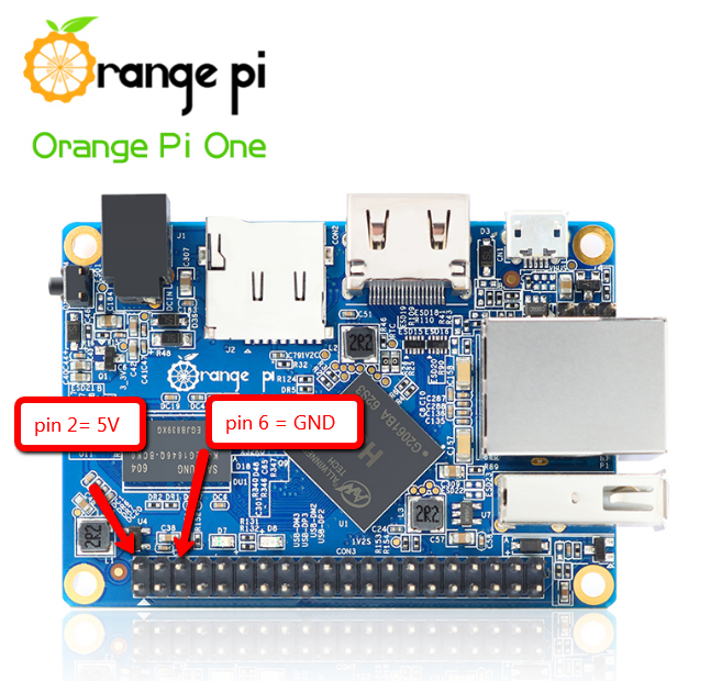

One other problem I had is that the power supply from the ASIC that powers the Orange Pi isn't working... Very weird, because it gives out 4.98 ~ 5.00V, and the power supply from my other Giant gives out ~5.1V. I'm definitely sure it's the power supply that comes with the Giant.
I think I'll just power the Pi from another power supply, or find another way around it.
Also, I had problems by copying the files to the new SD Card. I had to use an image I downloaded from I think Baikal's site and used Win32 Disk Imager to flash it, then changed the pools, etc and it worked out fine.
Here's an update on my Giant's power supply. Jason said that I'd have to send the Giant back for them to fix the power supply that comes out of the Giant and into the Pi. That's obviously not the best solution, so I ended up powering the Pi with a 5V, 2A charger hooked to a USB cable, to which I cut the other end to get the power (red) and ground (black) wires from the USB, and connecting them to PI's GPIO pins 2 (VCC) and pins 6 (GND), respectively. Hopefully this helps someone.
It's a kind of gruesome solution, but it has worked fine for now, and saved me the shipping back to Korea, the miner down time not mining Dash, and the taxes when it comes back in. Good business if you ask me.
