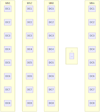

Let me try to give some additional explanation of the proposed solution to make it more understandable and add some additional thoughts on the subject.
The goal is to split the platform data between the masternodes, so that each masternode does not need to store the whole platform state, but only a part of it. We have many options for how to split the data. Here I propose to use the Data contract ID as the value by which we can decide which data goes to which masternode. I assume that there will be many data contracts (DC) and that most of the data will go through them. With this solution (at least in its current form), the interactions that store/modify data that do not have a Data contract ID will not be sharded, i.e. they will be on all MNs.
The core idea is that MN does not need to store information about data contracts that are not assigned to it.
The sharding concept - illustrated
Here is a graphical illustration of current situation (all masternodes store the entire Data platform state):
Here is the same situation with my proposal (gray squares are data contracts for which the payload is not stored):
The number of nodes that store a data contract's data is chosen by data contract owners. This is just an example.

So excellent ideas once again. But sadly there are a few things that you do not know that render this solution not as ideal as you might hope, and as far I can see right now doesn't seem to work.
Thank you very much for the answer, I appreciate it. I still think the solution is doable, but before I ask any more questions, I should really look at the code now. I do not want to take up any more of your time so don't feel obligated to reply.
What I will look at in the code is how the grovedb is structured in detail with respect to multiple data contracts. There is no such information in the documentation. The example for provable data queries is for one data contract only, not for the entire platform with many independent data contracts. How multiple data contracts are stored and accessed in grovedb is not documented, but has implications for the implementation of my solution.
After looking at the code, here is what I will be interested in next.
I understand that we have a merkelized groveDB structure that is necessary for proving queries, but can we assume that most if not all provable queries refer to individual data contracts and not the entire platform state? Are the data contracts largely independent of each other? What is the use case for provable queries that span multiple data contracts? How common are cross-data contract queries? What is the optimal grovedb structure?
It basically means that all data hashes must be on every node so each node can recreate the root app hash. You might think to yourself : that's fine, just store the hashes, and leave the payload empty, and you would be somewhat right. There are some contracts where this might be possible. One difference is that patches to data become impossible. Let's imagine you have a big document, and you want to just change 3 bytes at the end. Instead of just sending a 3 bytes patch, you would need to send the whole document again, and then grovedb would need to know the difference to indexes, so it would ideally need the old document to do a diff? Not sure how this would be possible, getting it from another node would be too expensive.
Does each data contract have its own subtree with secondary indexes? If so, then "all" data hashes do not need to be on each node. If my node is not in a subset for a DC, then it does not contain any data from that DC, but it also does not store any secondary indexes because it does not need to respond to queries related to that DC. As for updating, that is, patching the big document you mentioned, it belongs to a data contract that is not in my subset (not assigned to me), which means I do not need to patch the document. I simply forward the request (3 bytes) to another node and the node responds with a modified top hash for the subtree of the data contract (I know how to change the rest of the structure in grovedb). Communication is not expensive. I send 3 bytes and get back a hash.
Next, quorums rotate. So we would need to build a system where they stay relatively stable in the data they are supposed to host.
Are not the quorums in Tenderdash only used for consensus?

a request for example: "get me all people who send me a contact request since yesterday", groveDB can prove that the elements returned are both correct and complete. Without secondary indexes the way we built them you could maybe get elements proved to be correct, but not complete, or complete but not correct.
So, in GroveDB, there is a primary index on certain primary key, which is basically a selected attribute of a given type. Which one is that in your example? Then there is a secondary index on another attribute type. Which one is that? I understand that an index is a redundant data structure that helps to search fast. It is not immediately obvious however, how an index proves correctness and/or completeness. Can you explain that?
It is not a simple index. It is a merkle tree (also called hash tree).

there is still a CPU delay when trying to concatenate the data, but this delay is not an issue if you have a decent CPU and the data piece you target is not dispersed among too many nodes.
