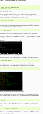

Hi, Again i have tried the same steps, please check the attached screenshot for your reference, the same i didn't find the mnprivkey this time also, ok as per your suggestion(just generate a new key and start it using that), how to generate the new key, as well, what are the config files, i have to change to run this server as testnet server(example:dash.conf), also how to run the dash as system service, so that it can more useful to start & stop the service, whenever we require, also how to monitor, if the service is unfortunately crashed & how to recover the same,so please guide me as much as brief & detailed, so that it will be more userful for us, to continue further.

Your screenshot doesn't show any errors - what am I looking at there?
dashman normally sets up a masternode for mainnet, so you will either need to follow the manual installation instructions or change a few settings in both dash.conf and sentinel. Everything you need to know is described at the links below:

As per your guidance only(https://docs.dash.org/en/latest/masternodes/setup.html), i am try to setup, but even though, why we got error, please check the attached screenshot, as well below as you requested above

Yes, I am the author of that documentation ;) I can't see any errors in the screenshot, what should I be looking for there?
When you start it manually, it seems like it is working fine. There is no failure or error exist code. So my advice at this point would be just don't use dashman for a testnet masternode. Can you confirm it is working as expected now? Otherwise please come and find me on Discord (www.dashchat.org) in the #masternodes or #testnet-lab channels and I will try to help you out in realtime.
