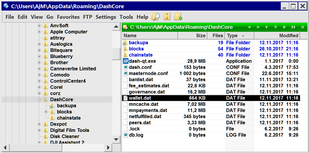

And wallet.dat is in the same folder where dash-qt.exe is located.
I need to correct my false info about where dash-qt.exe is located.
I did not use the installer, that is the reason for confusion.
If Dashcore is installed with install program in windows, then
dash-qt.exe is located C:\Program Files\Dashcore\ folder
and
wallet.dat is located C:\Users\XXX\AppData\Roaming\DashCore\ folder.
XXX = user name
