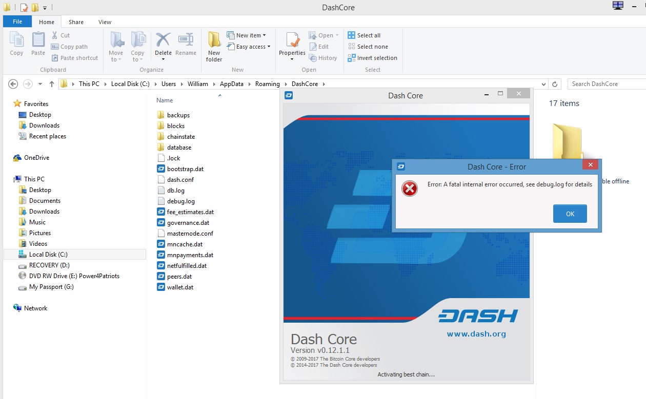

I just finished installing Dash v0.12.1.1.
Once the installation finished, Dash Core client started and I saw a message out of sync, syncing with the network.
A few minutes after this, I received a pop up message:
Dash Core - Error
Error: A fatal internal error occurred, see debug.log for details
(see attached)
I shutdown Dash and restarted.
I received a message: Block Chain Corrupted, Do you want to rebuild
  • Dash Core Fatal Error debug log.txt

2017-02-20 19:40:59 Unable to open file C:\Users\William\AppData\Roaming\DashCore\blocks\blk00000.dat
2017-02-20 19:40:59 ERROR: ReadBlockFromDisk: OpenBlockFile failed for CBlockDiskPos(nFile=0, nPos=131303)
2017-02-20 19:40:59 *** Failed to read block
This means that smth happened to the file where blocks are stored. Check your anti-virus if you have one and make sure it didn't move this file to quarantine or affected it in some other way. Also make sure you you disk is not corrupted. I'm not sure what kind of utilities there are on Windows tbh, should say smth like "scan disk for errors" or smth like that.

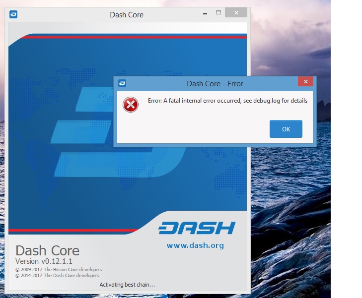

Getting a different error now (see attached screen shot and debug.log)
Note: debug.log was to large to upload, so made a copy and removed oldest info.
thanks
regards,
Bill
  • debug.log.txt
Hmm.. smth is still preventing read/write access sporadically, not only for blocks but for indexes also
2017-02-22 01:27:17 Opening LevelDB in C:\Users\William\AppData\Roaming\DashCore\blocks\index
2017-02-22 01:27:17 IO error: C:\Users\William\AppData\Roaming\DashCore\blocks\index\LOCK: Could not lock file.
Strange thing is that eventually it lets it go but then it just corrupts blocks again. My guess would be that Norton has way too aggressive heuristics.

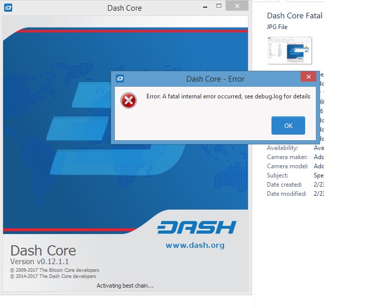

I am now getting a different error (see attached debug_022717.log and screen shot)
Any ideas ?

That's quite confusing... I know it doesn't sound great but I can't reproduce that even using 2 different machines and vm..
Try removing "blocks" and "chainstate" folder and open wallet again.
EDIT: please update you wallet to 0.12.1.2 - this should make no difference in terms of solving this specific issue (few bugs were fixed but they were not related iirc), so it's just to make sure we both use the same version while digging for solution.

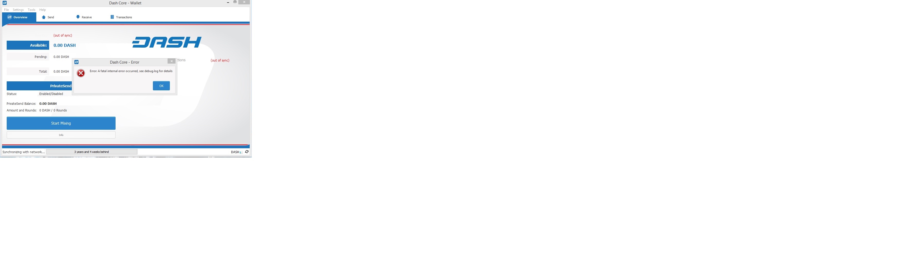

I went ahead and deleted the /blocks and /chain state folders and re-opened the wallet ... it recreated them and the block file (blk00000.dat) from the bootstrap file, but still getting an Error .
2017-02-23 23:54:26 ERROR: CheckProofOfWork(): nBits below minimum work
2017-02-23 23:54:26 ERROR: ReadBlockFromDisk: Errors in block header at CBlockDiskPos(nFile=0, nPos=387319)
2017-02-23 23:54:26 *** Failed to read block
(see attached)
Any more ideas ?
thanks
Bill

There have been a few windows 10 issues along the same lines that may be related to user profile corruption but I've not heard any feedback on it. The simplest test is to create a new profile and install the Dash client on that, if all runs ok there's plenty of info on fixing the corrupted profile.
All similar issues with bitcoin client I was able to find lead to the same root case - smth is wrong with the disk itself or with disk controller or its driver.
Some people were able to make it work after they did disk defragmentation, maybe try that too?
If you need to move funds and nothing helps, try installing wallet on another machine or in VM and copying wallet.dat there.
