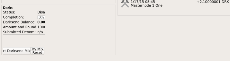

Yeah qt4 works but the interface looks bad for me. Missing words and disconfigured. It seems that even flare's gitain builds are compiled with qt4.

It's strange, I have removed all traces of qt4 from my system and have all dependencies to build with qt5 and yet it still seems to only look for qt4.
bash said:
/darkcoin-0.11.0.11-linux/bin/64 $ ./darkcoin-qt:
error while loading shared libraries: libQtGui.so.4:
cannot open shared object file: No such file or directory
