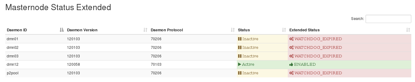

    Everything seems to be in working order. Dash Ninja even reports your port to be open, I don't know what could be the problem. Why don't you give it another try?

    Hum... now it's reporting watchdog expired. Are you running sentinel? Does it give out any errors? Is it called successfully every minute on cron?
    Edit: Added image
    #15 lynx, Mar 6, 2017

    Hi Lynx,
    It runs every minute through cron, and outputs:
    "Invalid Masternode Status, cannot continue."
