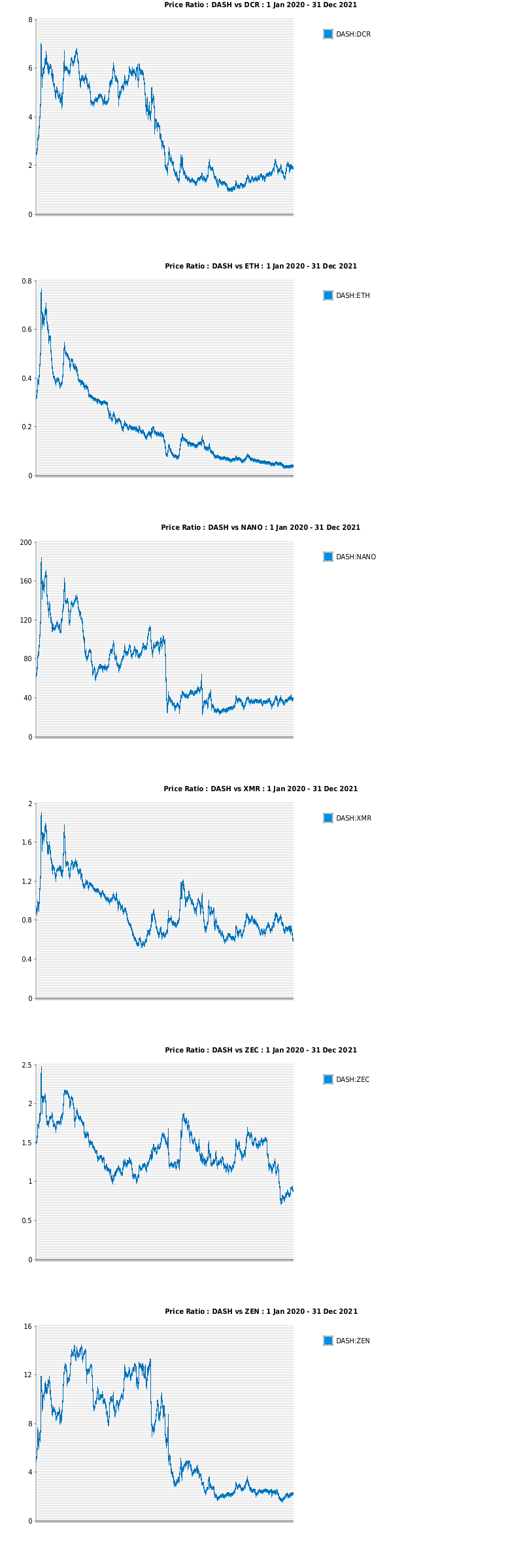

I have done a little digging and found that XMR, ZEC and ZEN have all output performed dash in the past two years. Even NANO did better than dash for the same time period. I understand DCGs position but two years of data proves them wrong.
The chart reads, how much SYMBOL2 can be purchased with SYMBOL1. An ascending line means dash is stronger than SYMBOL2, while a descending line means dash has less purchasing power of SYMBOL2.
Dash's privacy only works on the send side. Receiving dash is not shielded, thus needs mixing before use, and it doesn't stop people observing the total amounts entering the public address before mixing. From a user point of view, it's just not good enough. Usernames will help somewhat, but still, the simplicity of privacy-by-default provides a better user experience, and arguably safer as there are fewer hoops to jump through. Additionally, the use case for transparency-by-default is limited to a small subset of the population e.g. charities and public office. ZKPs on a side-chain would be better than nothing.
This is pure bunk, atributing Dash's slide against these shitcoins to our implementation of user privacy is pure nonesense, I won't go into the details of why the slide happened, that is discussed in another thread and your post is already very much off topic and opportunist.
