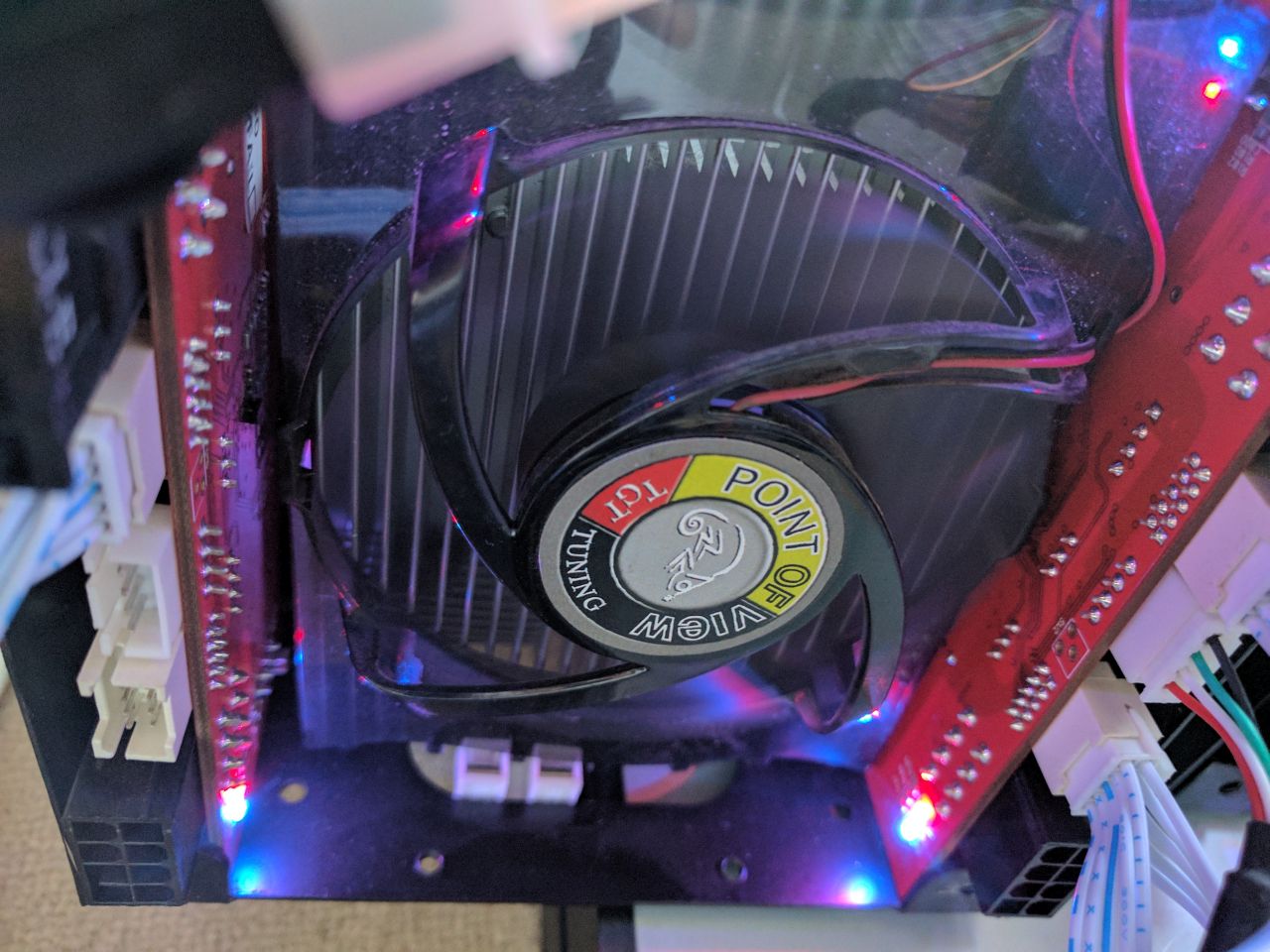

The Baikal Giant miners were too loud for my taste (see pictures of them arriving yesterday here), so I modded them by removing the superloud 12v 0.75a (9W) with CPU Coolers that perfectly fit (usually around 1-2W, so obviously less powerful) and also adding a bunch of older GPU coolers (5V, less powerful, but good to dissipate some extra heat on the other side).
Step1.jpg was to disassemble all the fan protection grids and than the single fan on the front, plus the side to remove the fan connection. Beforehand I checked which way the fan blows: It pushes cooler air into the miner, which usually is around 40 degrees itself after a few hours.
Step2.jpg was to find some fitting CPU coolers, I used 2 old Noctura CPU fans with 1.4W each, I recommend using multiple or higher amp ones (obviously not 9W if they as loud as the ones attached, but there are some big blade coolers that still would fit as there is nothing blocking around the coolers, go as big as possible).
Step3.jpg and Step4.jpg: Adding few more tiny coolers on hotspots (using my thermal probe), especially on the end it was getting hot as all the hot air is blown out from front to back, so each miner got 1-2 extra GPU coolers there. One fitted nice and tight and presses against the passive cooling from the inside.
Step5.jpg: Cables, I could have soldered everything, but I went for the lazy route as most things already where fitting nicely together. I could not get the old onboard pin connection to work with all fans, so I just connected a 'P4' 4-pin power connector and used Pins Spring Wire Connectors to connect all fans on each Giant.
Step6.jpg: Testing it all out, temperatures are stable after an hour now (first giant at 41 degrees, the other one at around 43 degrees, it was 1-2 degrees hotter before too, also the gpu cooler on there is much smaller, so maybe I will add a bigger one later).
Step7.jpg: For safety I added an extra outside fan, after an hour of testing it is still all stable at 41 degrees celsius, so it is probably not needed (will test later with out). I also added a gap below the miners so air can circulate all around it.
DO THIS AT YOUR OWN RISK and test test test, you don't want to have no fans working and the whole thing overheating and losing your warranty. For me it was worth it as it is now as silent as the Baikal Cube with 50% fan or as much as my PC when gaming.
